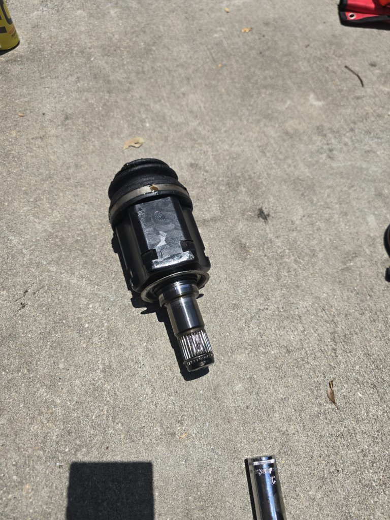

    Well. I just got a cv axle tool from autozone, but I won't claim to have had luck yet. I'm exhausted, frustrated, and fed up. I know it's easy for others, but this is grueling and I feel defeated.
    I genuinely don't know how you guys do it, seriously..
    Edit
    Rage, and a chisle that I didn't care about did it. Hitting the notches in the axle finally got it to budge. God damn!

    Oftentimes when a axle won't pop out it's because the circlip on the splines is expanded. The opening in the clip needs to be pointed down. When it's pointed up (12 o'clock) the clip hangs down and doesn't want to compress and let the axle come out.
    The tip is to rotate the axle 1/4 turn at a time and keep smacking. When you get to the place where the opening is pointing down (6 o'clock) it *should* cooperate better

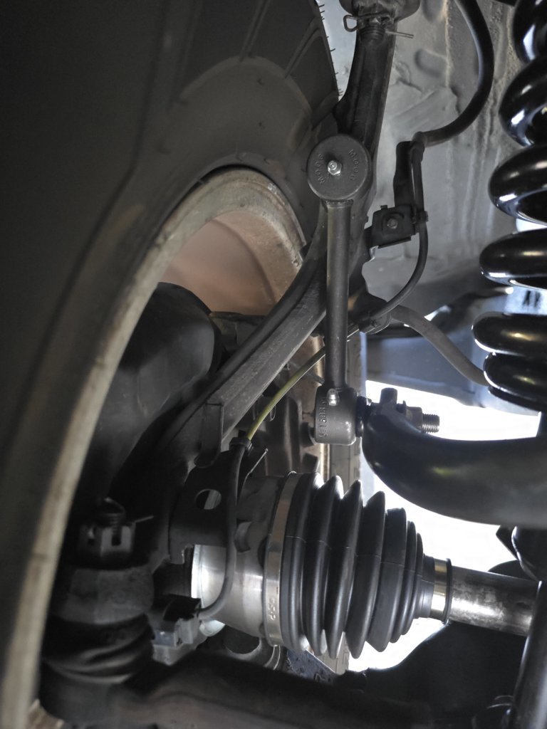

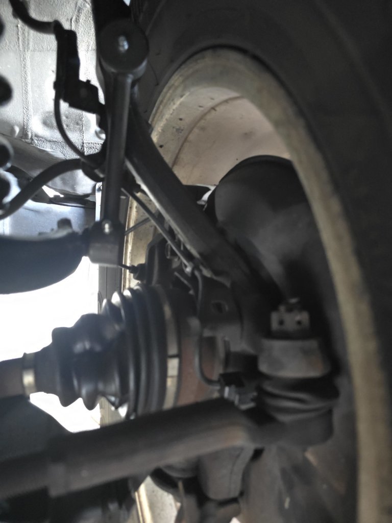

    I can do all that in probably less than an hour now.
    Quality tools help, but experience is the real tool. I've damaged way more things than I care to remember.
    Is the trucks control arms on jack stands? Looks like its sitting low, how is it sitting now?
  9. May 25, 2025 at 4:52 PM
    #49
    Madcat207
    Madcat207 [OP] Well-Known Member
    Jun 13, 2012
    #80623
    200
    FL
    08 Double Cab Long Bed Sport
    The Jack stands were on the forward part of the frame (checked where Toyota said to put them), but the wheels were definitely pushed down from the new shocks.
    When it was driving fine, the ride height definitely felt taller.. but changing from original 2008 shocks to new ones will do that.
    But now I have to figure out how I funked up my brakes. Don't even know where to start now

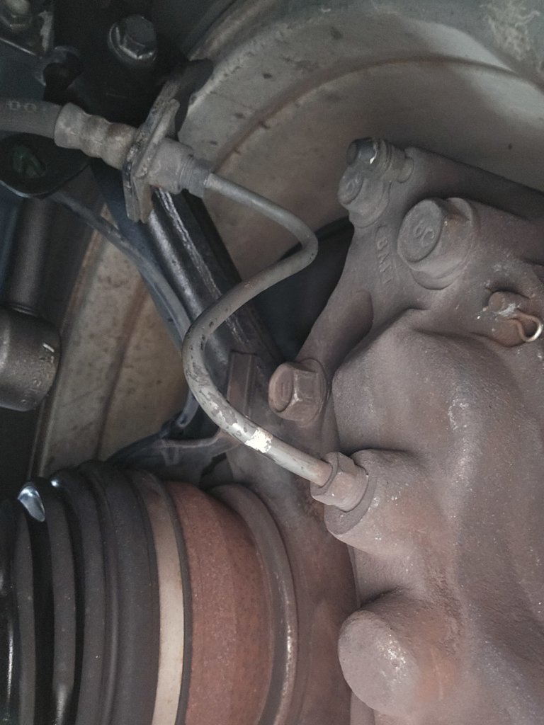

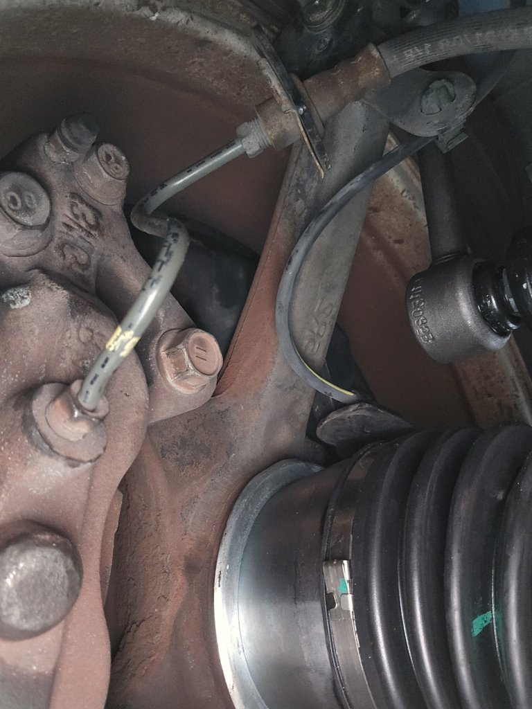

    Fully noted. However, given that I seem to have jacked up my brakes doing this, I think I'm losing motivation to do any of this crap again....
  12. May 26, 2025 at 5:33 AM
    #52
    dk_crew
    dk_crew Well-Known Member
    May 20, 2019
    #293798
    867
    Dave
    Austin, TX
    2005 Tacoma 4x4
    the brakes don't work? Or the hardline (that makes the S curve) got bent and it doesn't slot back into its place? Can you tell a bit more about what's going on with the brakes?
  13. May 26, 2025 at 7:39 AM
    #53
    Madcat207
    Jun 13, 2012
    #80623
    200
    FL
    So, i checked my ABS sensor, and they did have grease/debris on them, but still no bueno. Could be the sensor itself is bad, so Amazon is delivering some today.. cheap enough throwaway to try. The ABS light came back on after the cleaning, but when off again shortly after for what its worth.
    When the brakes do act up, they almost sound like the calipers aren't withdrawing (can't specifically isolate a side), as i still hear a "grinding" like they were somewhat engaged. I know I haven't dumped all my fluid (that's what she said) as the reservoir is still full. I don't think i pinched the tubes, but i can look again i guess.
    Open to more ideas (and take it to a shop is a valid one sadly), but I'm gonna spend some time with kiddo today and regroup tonight

    Specifically, i have had the ABS light come on twice, and when braking down my road, the brakes shudder as if i was slamming them on ice and ABS was kicking in. I notice after that some "grinding" sounds remains. What is odd, is that i did 20 minutes of driving just fine, and it was only at the very end grabbing dinner, that the brakes.... broke
