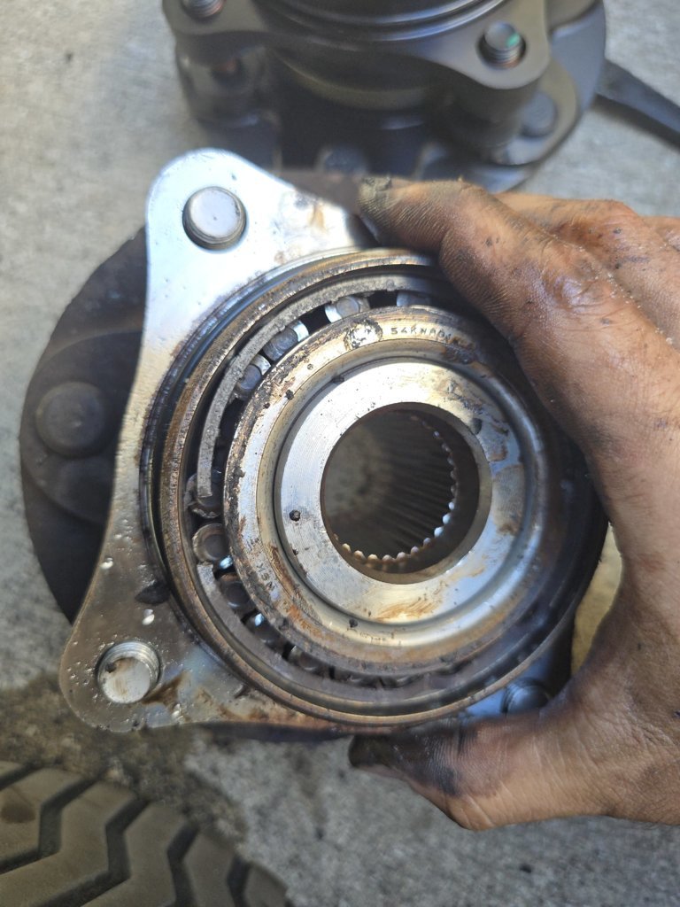

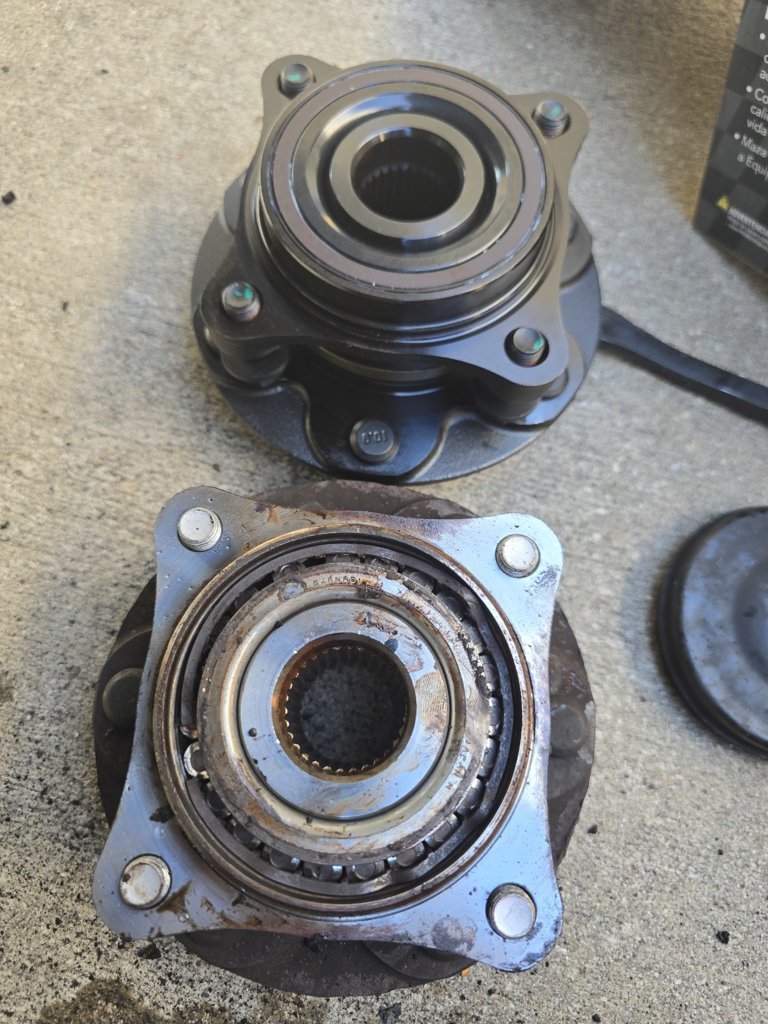

    So, been really thinking this all over, and my next step is going to be changing the right wheel bearings. I knew the right one was going for a while, as i would have a hum that would go away turning left. But i noticed a ton of gunk when i was changing the axle, and as I have been sitting here.. something else just clicked on me. I saw a tiny spring when i was looking into the bearing hub, and a little surprised to see something so small and delicate. However, after reading what i have about the ABS sensor, etc... i think that may have been the coil embedded in the hub that would be read by the sensor. So, if i can see that, it means that hub is not in good shape (and yes, i touched it, i know....).

    So.. old bearings came off today, and to say they needed replacement is an understatement, regardless of the brakes...
    So far driving it feels good. No abs light, and initial driving is good. Brakes were mush at first but I had pushed the calipers back, so that made sense. A few good pumps and they were happy. Going to keep testing before I call success. Having never done ANY major vehicle work, I am now up to:
