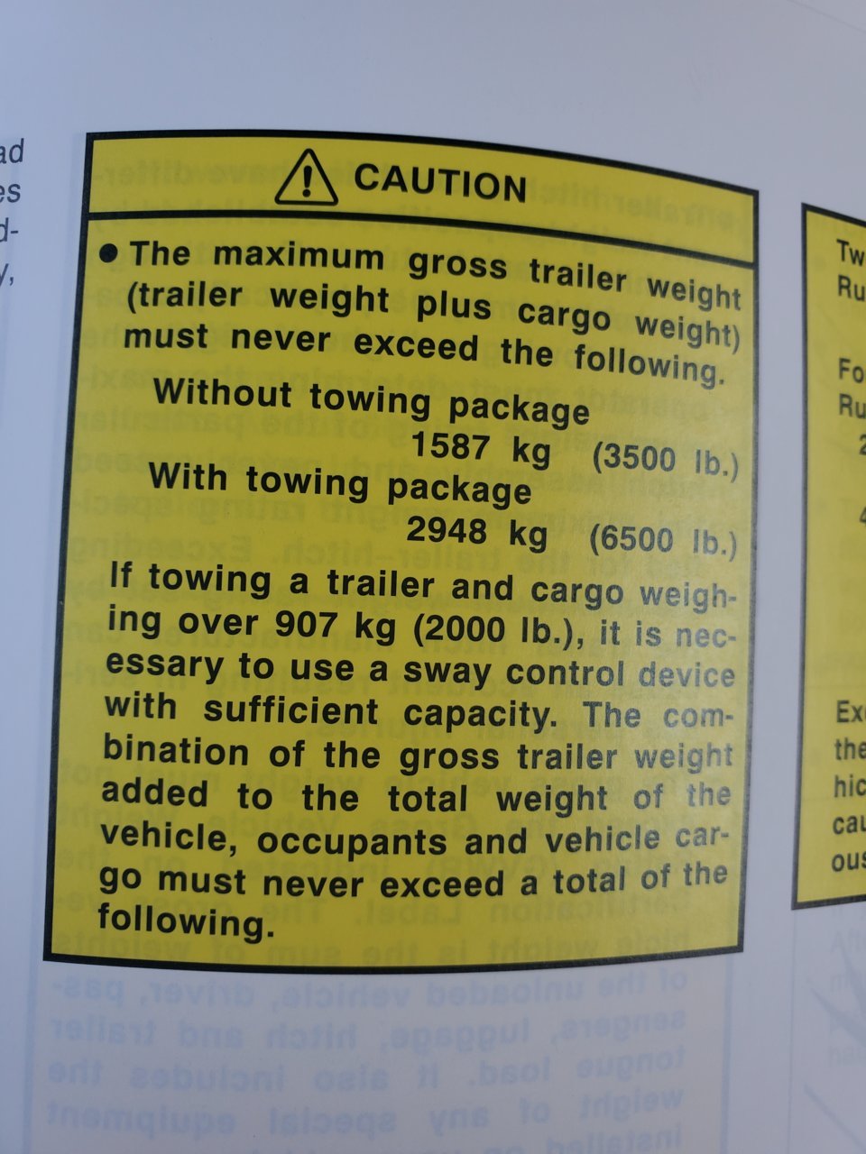

    Same for the 2nd gens as well. This is straight from my '08 Owners Manual.

    I'm at 3500 so all good. I do have a brake controller.

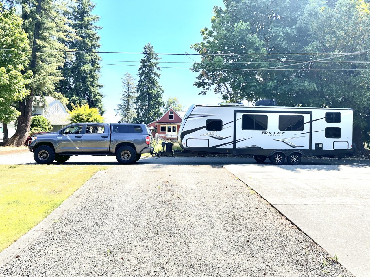

    Buy a tundra. That’s what I did knowing we were buying a larger travel trailer.

    a tundra is going to be a much more comfortable tow vehicle. but you could make it work with a taco with a smaller trailer.

    That’s not what that says…a 3500lb requires a sway control hitch according to Toyota.

    Like I said I have the unicorn, no sway hitch needed.

    That's a nice tundra. Sadly I never imagined I'd be living in a TT when I got it at 19 y/o. I didn't even think I'd be an engineer either but things seem to change in unexpected ways. Now I'm just too invested in my Tacoma. I'd rather downsize the TT then trade in the truck.
