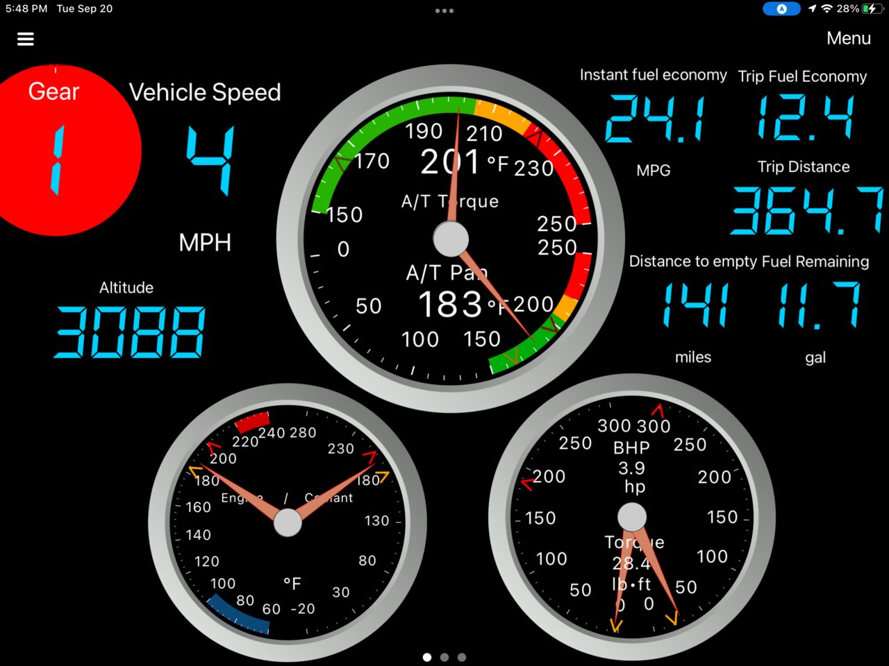

    TBH I drive in S5 without ECT whilst towing most of the time and selecting lower gears if necessary. With ECT on at 63mph the trans wants to be in 4th, without ECT the trans will stay in 5th. I consistently get 12+mpg on long trips including mountain passes. I use ECT for engine braking down hill only.
    Tacoma user manual does recommend ECT when towing but only mentions being outside of D when you need engine braking.
    Well worth pinning your transmission thermostat open for towing trips. TBH whilst I’ve been in AZ this summer I’ve left it pinned.
    https://m.youtube.com/watch?v=KB3Xbx97Emw
    Torque converter lockup - it only locks in 4th, 5th & 6th gears.
    Easiest way to think of it is when the torque converter is locked up the transmission does not heat up. If you’re climbing a hill and the TC is not locked the oil will heat up rapidly. In simple terms the TC locks up when there is not too much pressure on the gas pedal. On my OBD dashboard the red circle turns green when the TC is locked.
    For me acceptable temps coming out of the TC are a max of 230’f and pan oil temps should stay under 200’f. Monitoring the TC lock up status is key to keeping oil cool. In 8k miles of towing a 5k trailer over most of the mountain ranges west of Kansas I’ve only seen pan temps go over 200’ once. That was climbing south of LasVegas into a headwind along Hwy 95.

    Nice to have the lock up indicator. On my scanguage I use the increase in temp to know when it unlocks!
