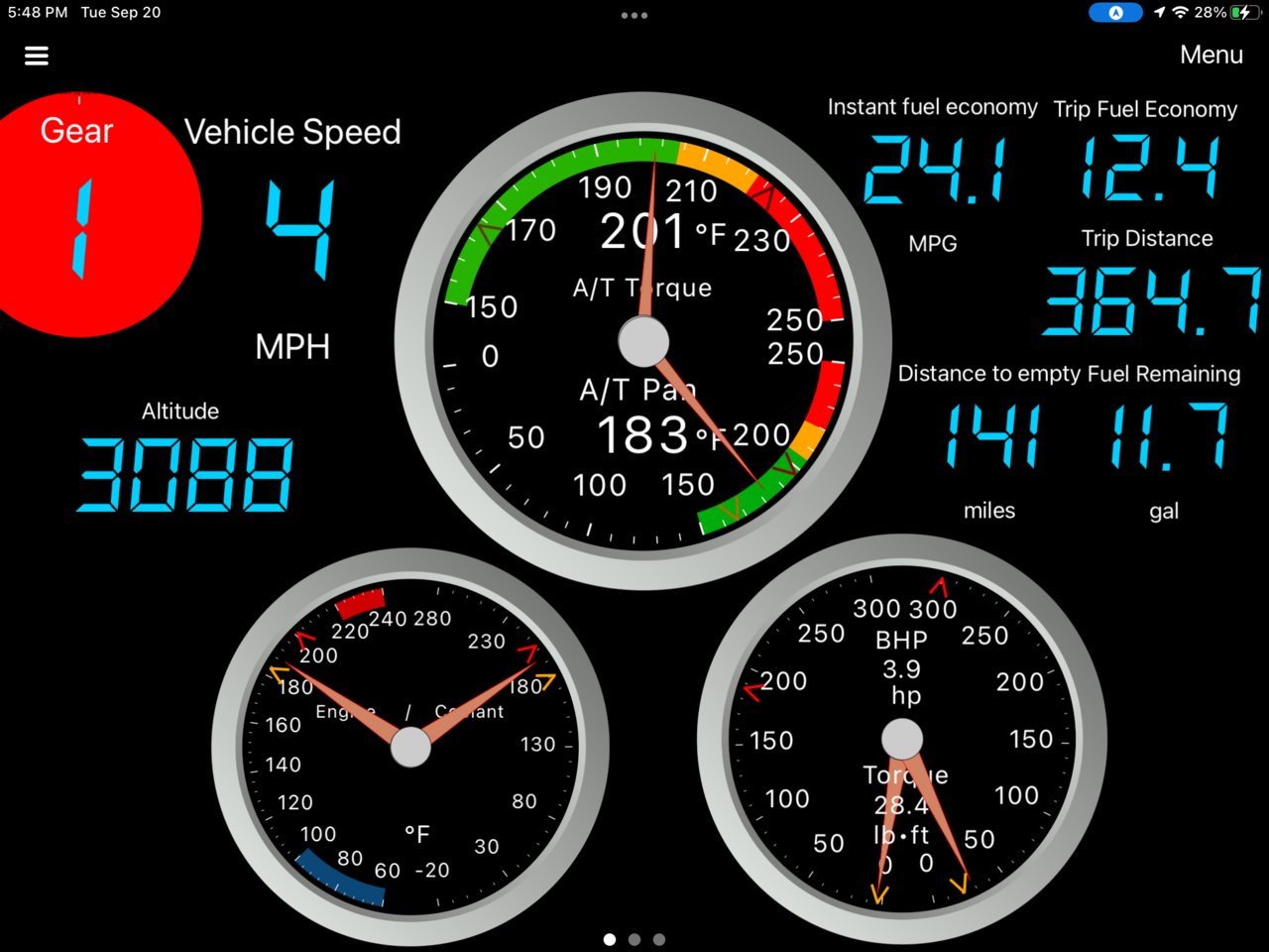

    My opinion is you are consistently running cooler, I'm at about 185 with the thermostat open. On my next trip, Ill have to note the coolant operating temp but I don't think it's much lower. If Im running close to the thermostat threshold when it's open it will be constantly opening and closing anyway. Heat is built on the hills and long pulls. Why not start with the lowest possible temp to keep the peak temp lower? Small red arrows show peak temp.

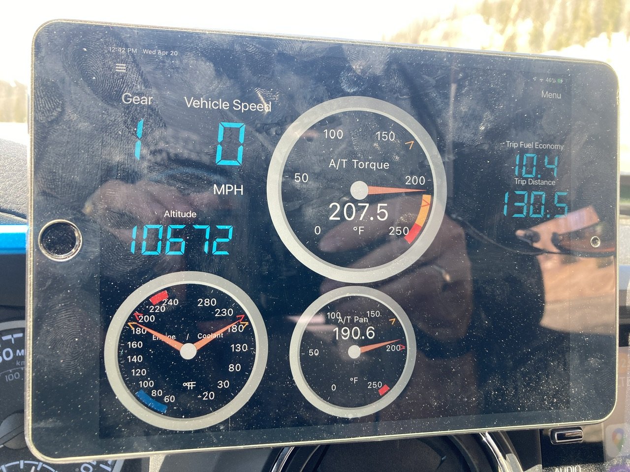

    biggest advantage to a WDH on a small trailer is that they typically have sway built in, when that semi comes past at 80mph you won’t have the push/pull that would happen without it. Also it’ll push some of that tongue weight to the front axle for steering.
    Thermostat on the 3rd gen is around 186’, having it pinned means operating temp will typically be 15’ cooler and that can help considerably on climbs. Especially if you’re half way up a climb and you hit a little plateau your pan temps will drop back down again.
    In 7k miles of towing a 5k TT over plenty of mountains I never saw pan temps over 200’. Here’s a shot of my dashboard as I peaked Wolfcreek pass in CO, 10k+ ft elevation. Torque converter never got hotter than 217’.

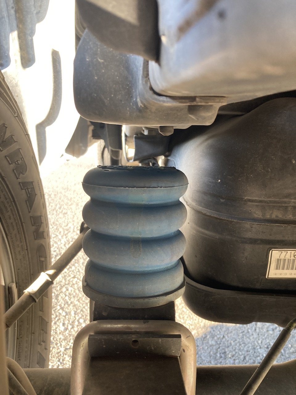

    Honestly I can’t say enough good about it as long as it’s setup correctly. The most critical part of setup that people don’t do correctly is when setting the hitch to the ball, the hitch and back of the truck needs to be lifted 1.5-2” above resting position by the tongue jack and then the nuts need to be tightened 3-4 turns. The red nylon bushings should be slightly swollen. If you’re measuring fender heights before and after and getting them within spec the ride is awesome.
    I have nearly 2” of clearance between the top of the sumo and the frame when unhitched and I can still see daylight when the TT is hitched. Sumos will help with compression/rebound when you hit big bumps in the road.

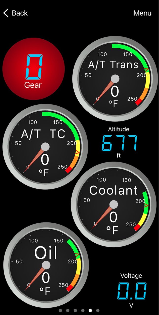

    @TexasTacoTuesday the next important thing to recommend is to get OBD fusion to monitor trans temps and so you can see when the torque converter is locked up or not. I have mine set so the red circle behind the selected gear turns green when locked up.
