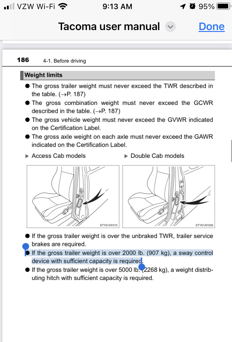

    #282137
    554
    Tim
    2024 SR5 4x4 long bed
    If I remember correctly, the manual says anything over 2000 pounds requires sway control. What he wants to buy is definitely over 2000 pounds.
    mosccat likes this.

    3,707
    Mark
    Currently in Bend, OR
    2020 OR
    Yes, sway required over 2,000lb. And they also recommend any trailer over 3000lb to have double axle. I wonder if that’s for the extra braking power?

    3,707
    Mark
    2020 OR
    @SmoothTRD FYI the same goes for the 4Runner, 2,000lb sway control required.

    Are you saying you simply haven't needed it based on your own driving with a load/trailer or that your manual does not include this statement?

    317
    I am saying I took my truck and trailer to a hitch shop, they looked it over, drove it and determined that they didn't need to install anything further.
