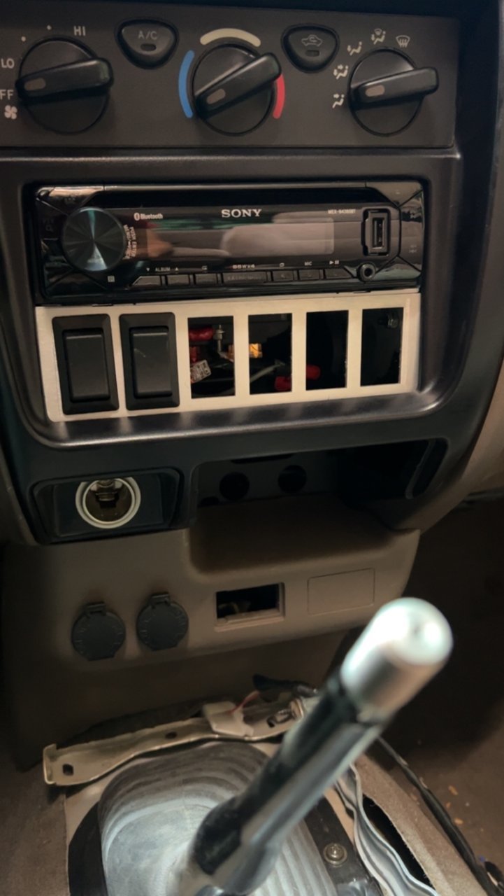

    My switch panel on my 1st gen was custom but not too hard to install: IMG_7004.jpg
    and that's basically it. again watch some YouTube videos about it. Equipment you'll need is gonna be some butt connectors, heat shrink if you're fancy, electrical tape, wire strippers and zip ties. Good luck and let me know if u have questions!
