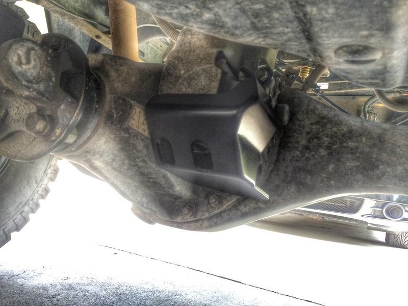

    Hey guys a few months back i bought a 2010 Tacoma which had the RR diff lock button but when i pressed that instead of locking the diff it turned off the rsca
    U think there's something wrong with the wiring ?
    And if i go under the truck and inspect the diff is there anything that indicates if I have the diff locks ??

    Look at your rear axle where the drive shaft meets the pumpkin. You will have a small (Coke can sized) electric motor to the right of that.

    There will be a elocker unit on the drivers side front of the diff

    This is what I've got when i press the RR diff lock button the Rsca off light comes on
    And i checked my diff i don't have the electric motor on it so no diff lock :(
    I don't know who the hell put that button in
