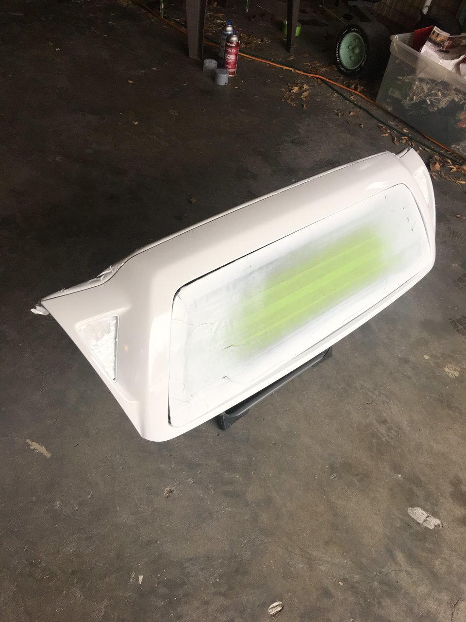

    I ordered color matched paint from Automotive Touchup. I got the paint, plastic adhesion promoter, primer, clear coat, and rubbing cream. My grill surround looks factory painted.
    Total cost about $45 I think.

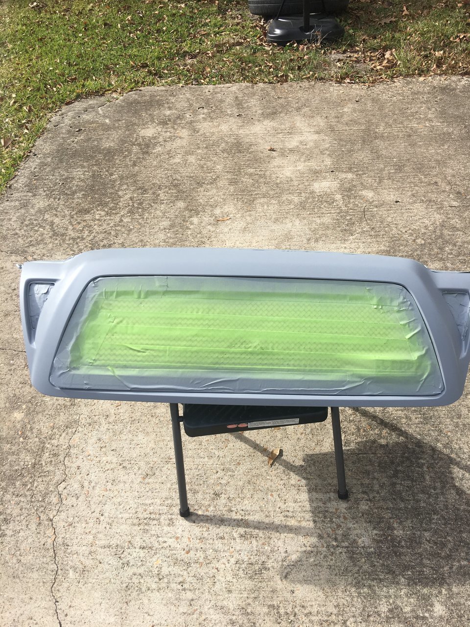

    So I just purchased an X metal grille with the chrome surround for $100 which seems like a decent deal. I'm thinking about painting the grille surround color matched or black since I'm putting on a SOS black front bumper. In your folks opinion, should I just sand it down or my buddy has a sand blaster? Is that overkill, I don't want to kill the plastic?

    I was a sand blaster for 3 years and it's all about the media you use. Yes it's an over kill for plastic but it can work if you do it right. So just go with sand paper I did mine with 320-600- primer-1200-primer-2000-color-2500-color-3000-clear clear clear haha it's came out factory. But I know theirs a lot of other ways to. So just see what some other guys did to

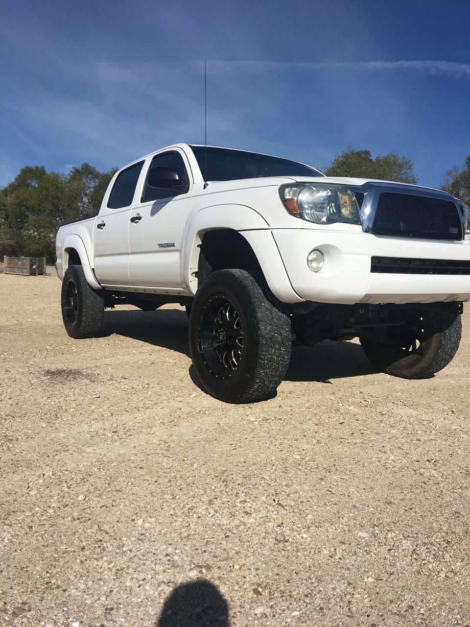

    What kind of lights are you running in the fog lights? Those are cool bro. I think I’m gunna go all led after I get my new headlights in
