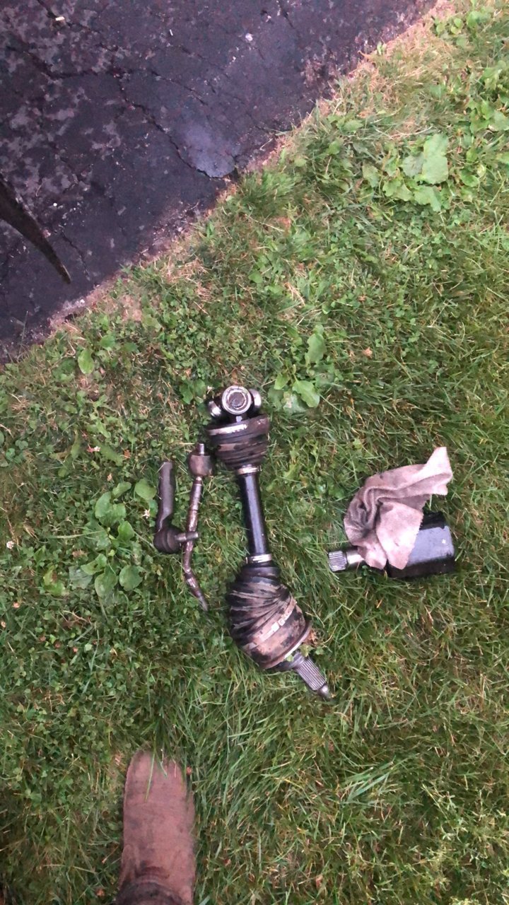

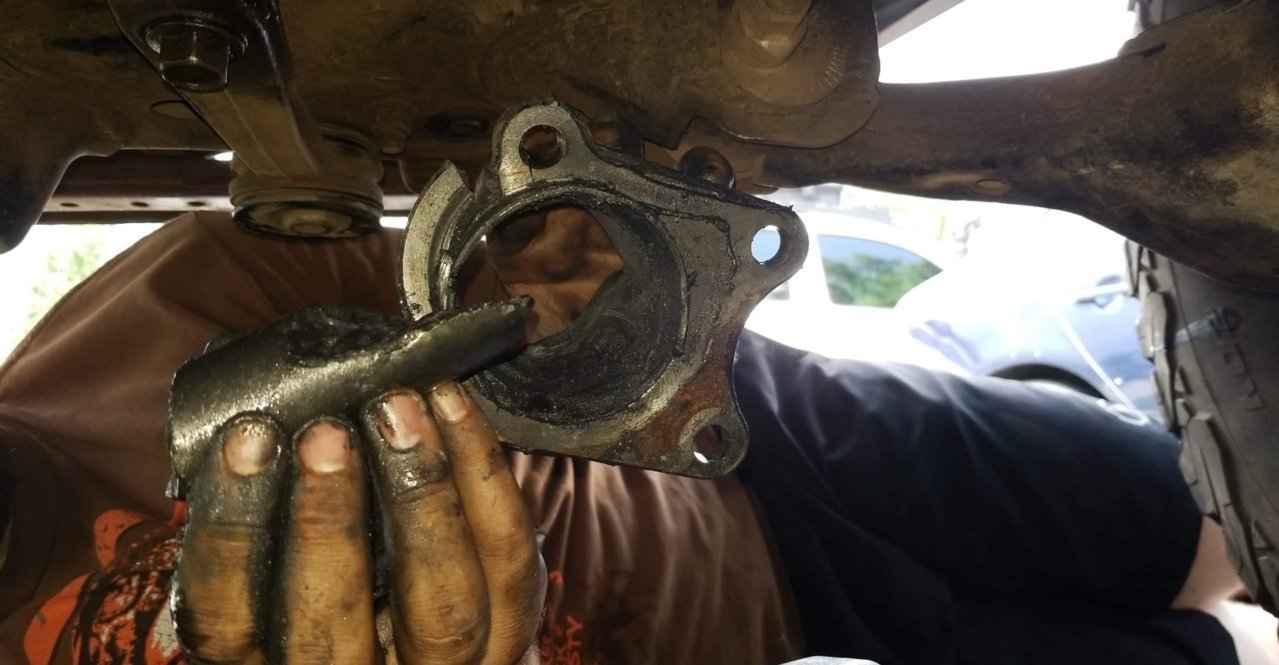

    Don't hop. Don't try powering over anything at full lock. Watch bind at full droop. Limit strap the front just before bind occurs.
    My rigs dual cased and these all happened in lo/lo. No wheel spin, all bind.
    Carnage:
    No more carnage:

    That makes sense, full droop or lock, worse angle on the CV axle, and 4lo x2 means mega torque.

    I bet that made some lovely noises when it finally gave lol thanks for the thread input.

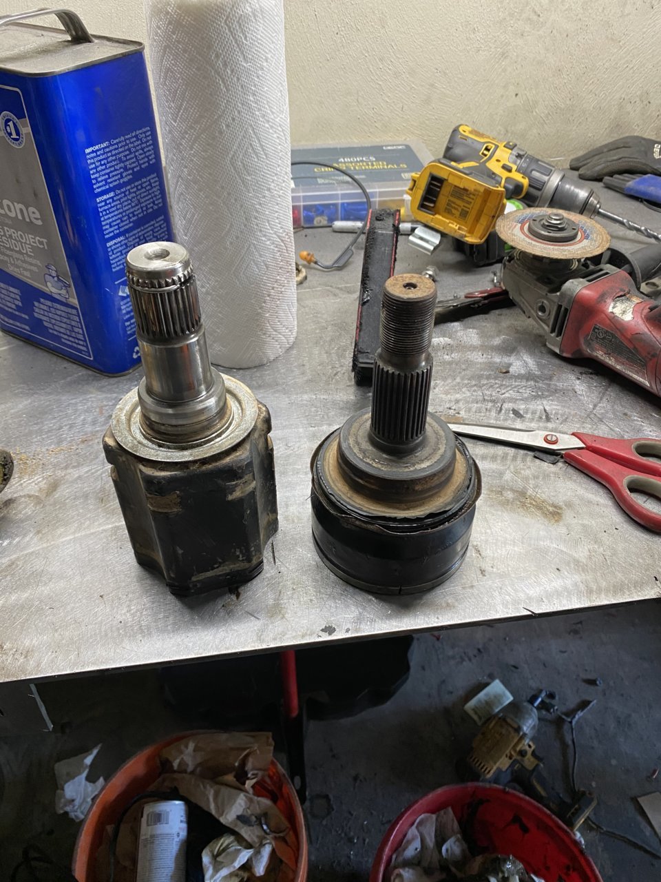

    J100 (Bougie) & UZN215 (Spartan)

    The best one was Dusy 2 years ago. I'm just starting up Thompson Hill. About 100 yards in there's a line that I took to climb a 28" high tree root mass on driver side. I had to turn full lock driver to avoid another large boulder with the passenger side. I was looking right at my front drivers side tire to line up. Full lock and lined up my rig barley started to climb. Then it stopped. Then I heard the gunshot and got to watch a ball bearing from outer tulip go flying out of sight. Yep. I'll never forget that one. lol

    We estimated around 5K Canadian in repairs so far, everything is completely blown... :annoyed::boom:Good thing between our group there is no lack of spare parts, shafts and tools. Now we may start carrying front differentials too :anonymous:
