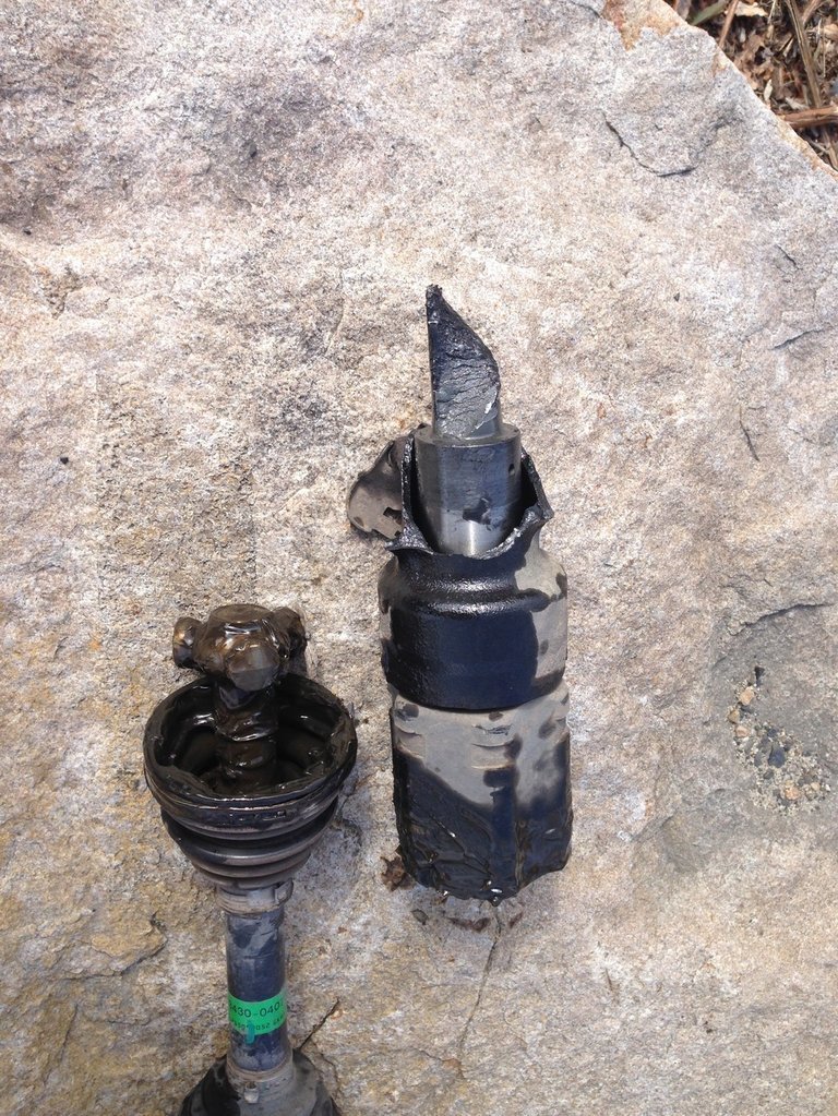

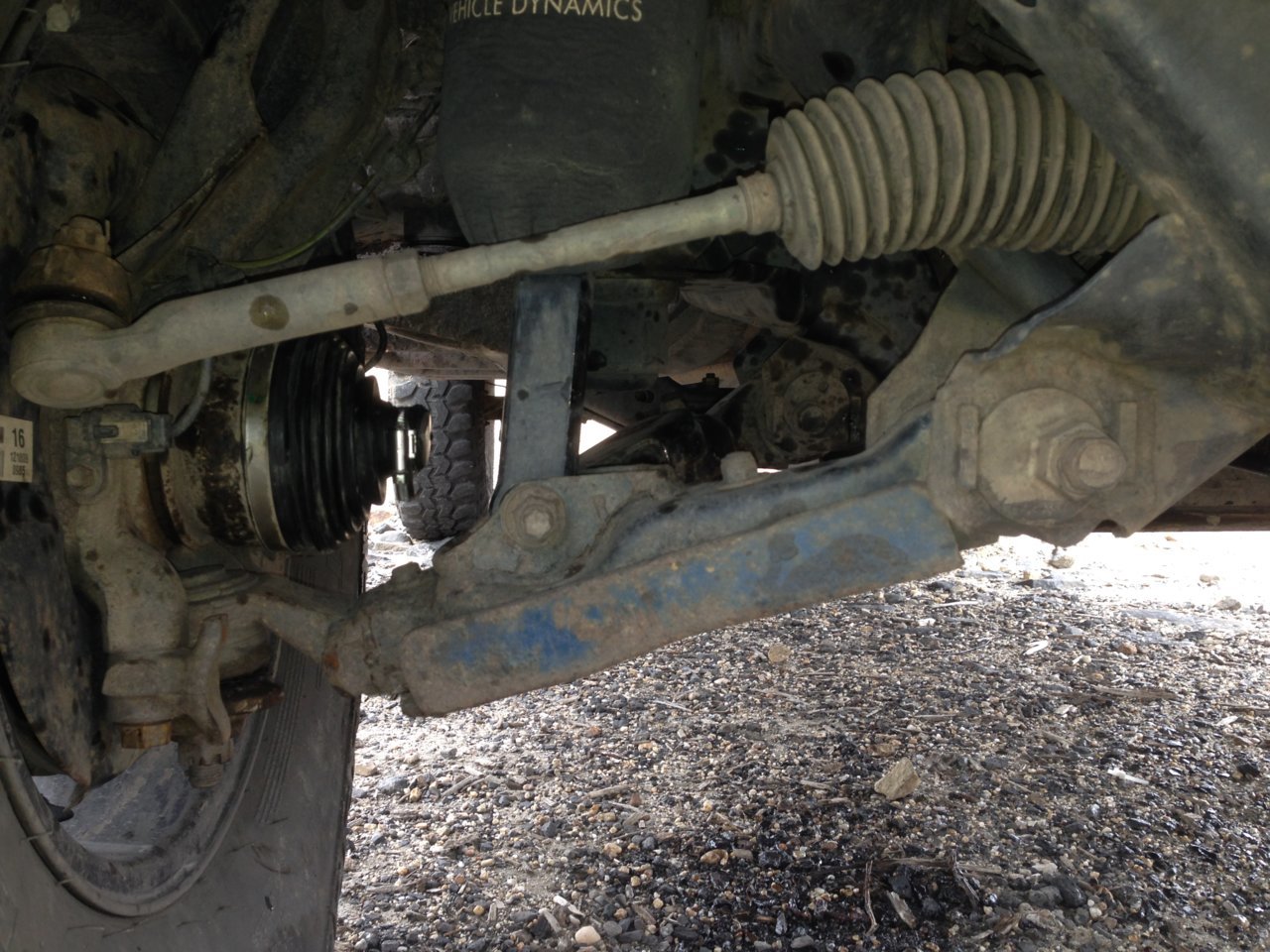

    Here's some advice, I've had a locker for over 5 years. Used it a minimal amount of times, only incurred damage once and that was due to my inexperience and lack of knowledge on the line I was on.
    You can use it with the wheels turned, steering will be damn hard though. Be very cautious, if you feel binding, back off immediately and assess the situation. The front ends on these trucks are very stout despite what people may say.
    Avoid wheel spin with it locked. Shockload will kill the front end. If the front locker is engaged, you should only be in 4lo with a good reason to use it. I sometimes like to ripping around with the rear diff locked, this is NOT the case with the front end. Steering is very tough if you're trying to make tight turns.
    I view it as a last resort, if the obstacle is not able to be passed then engage it. Try with rear locker first, maybe multiple line approaches. Depending on the condition, maybe even consider winching before engaging a front locker as well.
    There are times when it is super useful, if in a straight line and say you don't have enough droop, a front locker is great to get you through an obstacle. I disengage it as soon as I don't need it anymore.
    Here's my carnage at Rausch from about 4 years ago. Fast forward to the 5 minute mark, 5:19 for the exact point of carnage, you can see my drivers front wheel turning and my passenger wheel locked up in a rock. I was in double low with both lockers engaged. The result was a shattered ADD tube, surprisingly the CV survived, but I had to sacrifice it to get home without a tow (I now have an outer CV stub trail spare to use for situations where a CV is broke and get home)

    You are welcome, one other thing I didn't mention but it may be obvious. It's alot easier to break things on the front end with it engaged, I'd recommend at a minimum carrying an inner TRE, outer TRE, and CV axle for a spare. There are alot of people that opt to regear and not get the locker due to the added cost, but my theory was always buy once cry once. And "it's better to have it and not need it, than to need it and not have it". If I'm out wheeling by myself and that front locker gets me out of a bind I'd otherwise be stuck somewhere or calling for a tow, I consider that a cost effective modification.

    The noises in this video make a trip to the dentist a walk in the park!

    Haha, yes rewatching that video brings back nightmares, sounded like a shotgun went off from inside. it’s a warn 9.5xp-s, very strong bugger and not given me a lick of trouble for 10 years.
