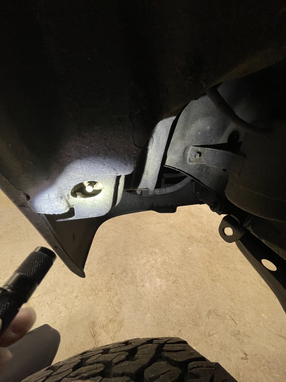

    Only seen videos on how to remove the 2001-2004, is the 98 much different? Or is it the exact same?

    I can't seam to get the two bolts on the very ends (directly in front of the tire on each side) out

    yeah can't brake them loose

    Use 6 wall sockets, not 12.
    Better to use a quality socket that grabs the walls and not the corners.

    Figured it out. Turns out the nut in the picture was welded on or something and not the nut/bolt for the bumper. The actual one that I needed to undo was below it.

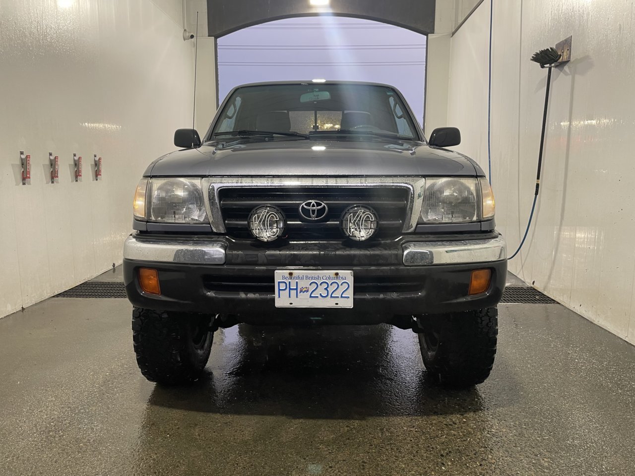

    Replaced the Grill, Front drivers side chrome end cap, headlight, and turn signal.IMG_3522.jpg
