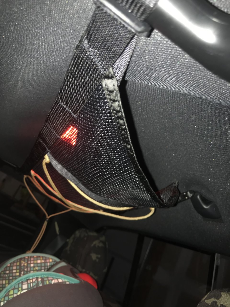

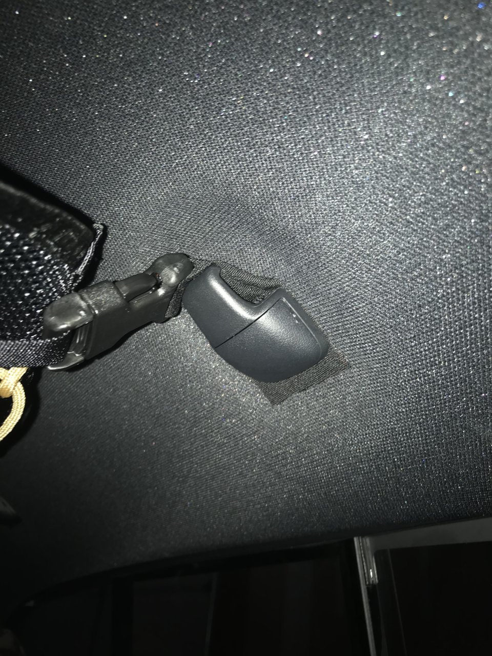

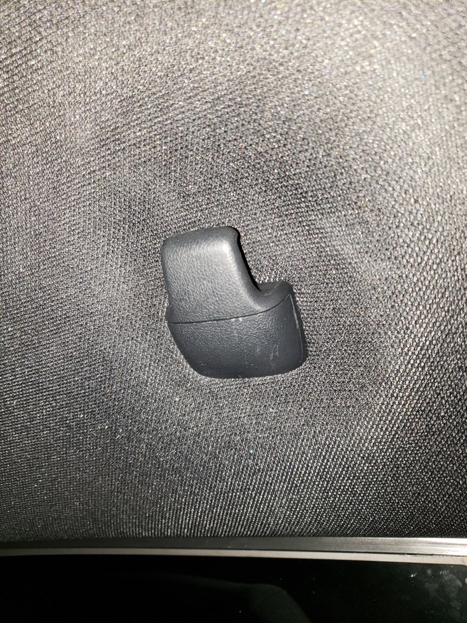

    I just put my Tacoma attic in two days ago. It’s a pain in the ass as there is no screw.
    Pop the plastic cover off, squeeze the ends of the metal clips together and the clip and hook will both come out. (Sometimes the clip stays and the hook comes out, just wiggle it around).
    To reinstall:
    The attic fabric should dig snugly around the plastic to hold it in place. Place the back of the plastic hook first into the hole in the headliner followed by the metal clip into the hole in the hook from the front to the back.
    Then the outer plastic for the hook should spread the metal clip against the roof as you insert it into place in the hook.
    Ask if you have more questions. It’s a pain in the ass.

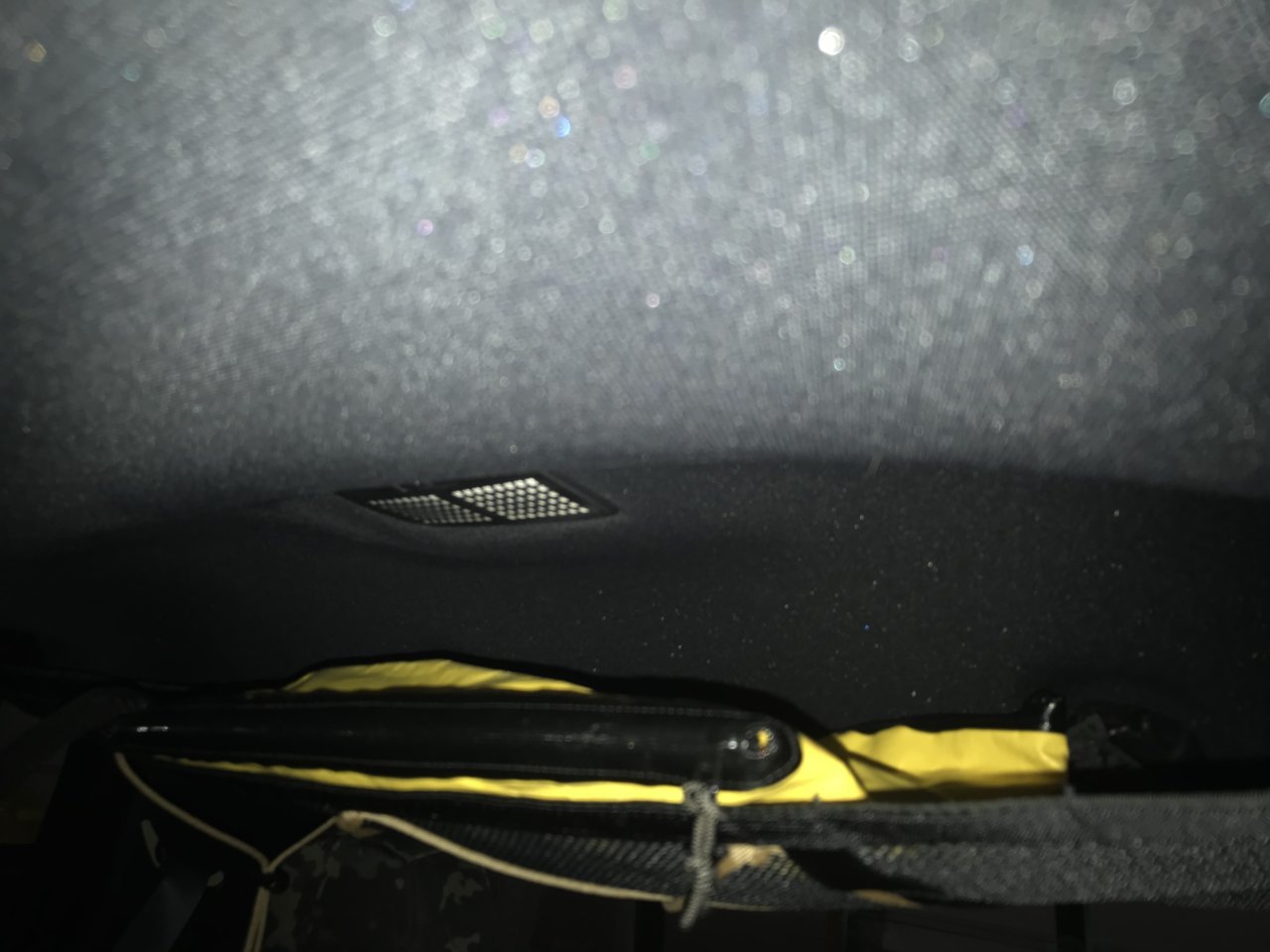

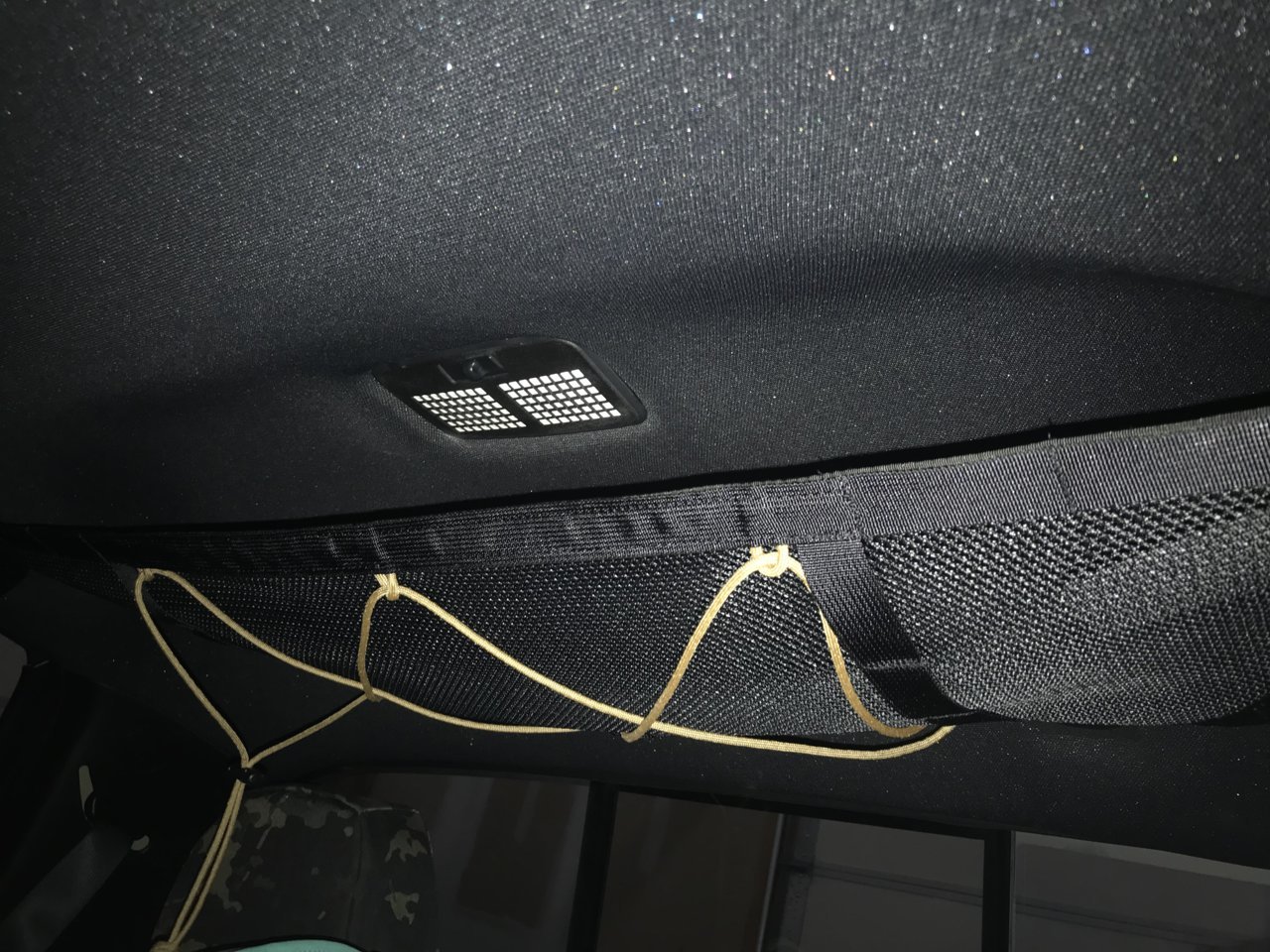

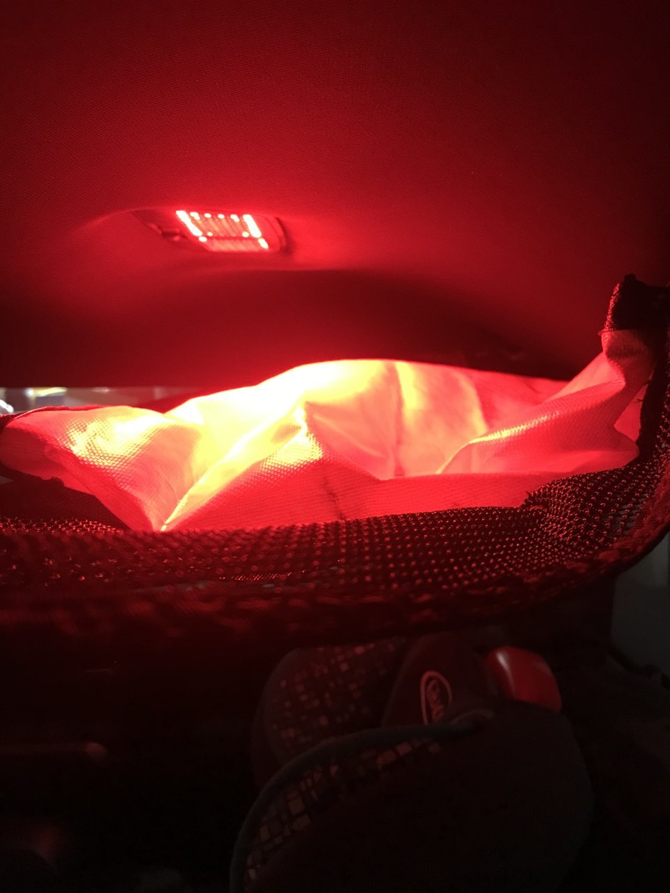

    How about some pictures of this Tacoma attic installed? I've never heard of one.
    Kheiron and Crodell6 like this.

    Phone pics are shitty in the garage. Not enough light. Let me know if you want another angle.

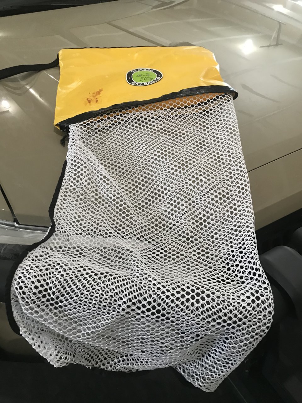

    I use it for all kinds of stuff when on trips. But, I keep an “icky bag” in it at all times.
    Not to derail the point of the thread...
    So, the Icky Bag is a semi waterproof bag (it isn’t a dry bag, and will leak by design to avoid mildew). It has two openings. You put disgusting clothing articles in the top opening and zip it shut. Muddy, bloody, or stained with a sour cherry beer (see stain on mine) it holds the articles and keeps them from soiling the rest of your stuff.
    When you get home the bottom unzips and your stuff is contained in a mesh bag for you to then hose down and or wash the articles while they are still in the bag.
    It’s pretty nice and mine has been through a few wash cycles.
    I had a growler full of cherry sour beer that wasn’t sealed properly at the brewery blow up on my back seat. It soaked through a few shirts I bought there and I didn’t catch it for about 12 hours of driving. This whole mess was on TOP of the icky bag and that’s the only stain it got. I’ve had bloody scrubs in it, muddy shoes, oily gloves, and all other kinds of things in it.
