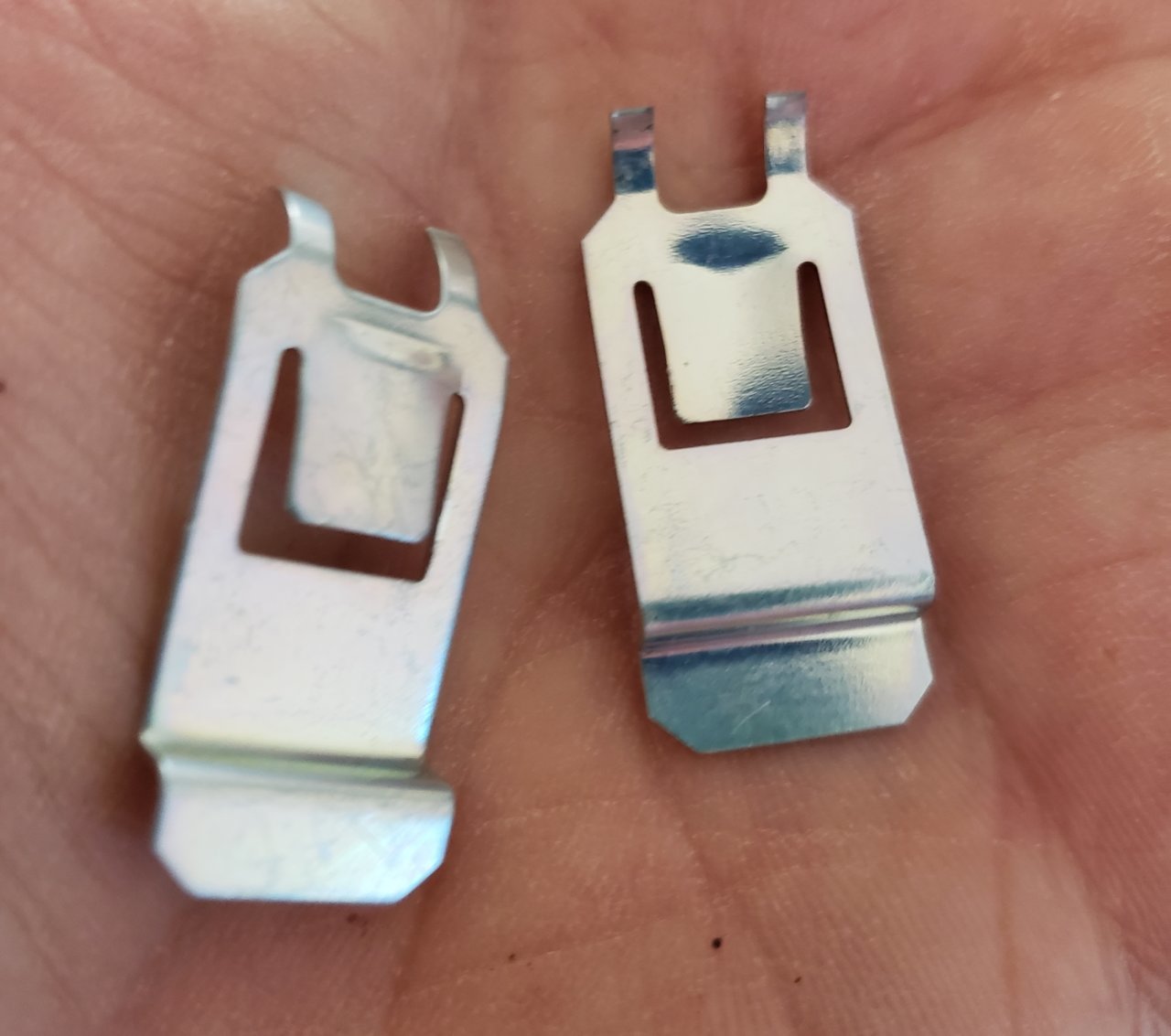

    Got one installed and when installing 2nd pone the metal clip snapped.
    Time to order a new clip.
    Here are some tips to installing a TOYOTA TACOMA ATTIC.
    1. The Blueridge Overland instructions suck.
    2. The two Clothing Hooks in 2017 Tacoma are clipped in. Why they are not screwed in i will never know. The design sucks.
    3. To remove there are 3 small rectangular shaped cap pop offs that can be pried open with a small screwdriver
    4. After you pop off cap you will see silver clip. Just squeeze close and hook comes out.
    5. Now you can install TOYOTA TACOMA ATTIC.
    6. Dont break any little parts removing or installing like I did.

    Just called local dealer, can get hook and clip i broke for $12 including tax.
    Your right BROG is high quality but HORRIBLE instructions.

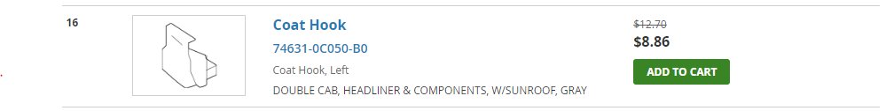

    I need one of these clips too, do you happen to know a PN?
