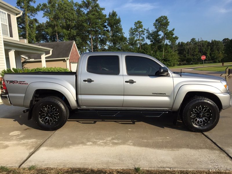

    so I've been doing some mods to my new ride in the last few weeks and decided to pull the pin stripes off today. Down here in the 100 degree sun the stripes peeled right off, but the so,e of the glue from the stripes is still there.
    How can I get the glue off?
    (Before and after pics posted as well)

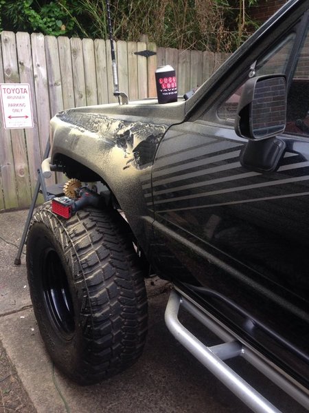

    I removed 20 year-old baked on stripes from my '95 4Runner a few weeks ago, and there is still tons of eggshell in the paint from the adhesive. I also tried a bunch of different chemicals, including HD Goof Off, but they were really rough on the paint. The only thing that worked, but took lots of patience was a 3M Stripe-Off wheel. It's basically a giant eraser for a drill.

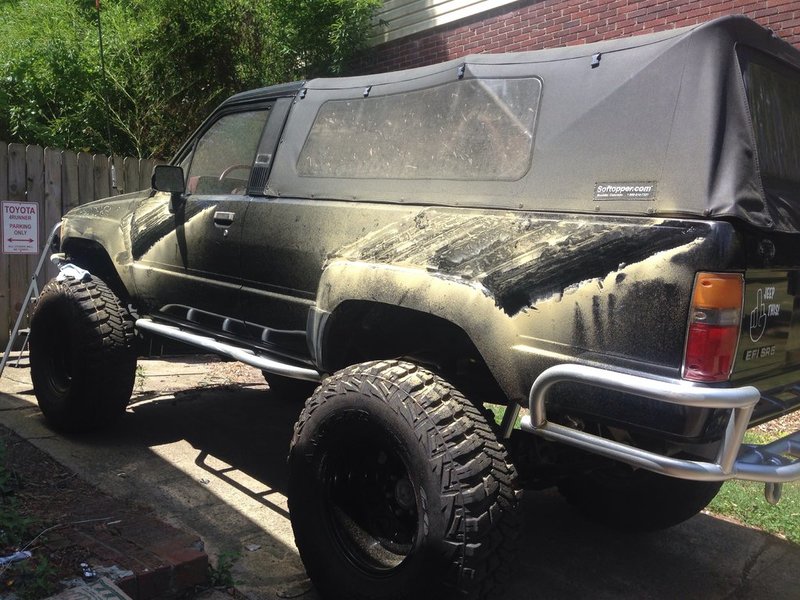

    I used the 3m wheel on my 4runner's SR5 stripes. Heat gun got a lot of it off, but the wheel worked great on the dried and cracked sections. It removed the adhesive well, was a bit time consuming but I think any method will be. It makes quite a mess though.
