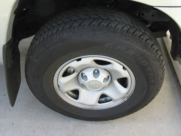

  9. Sep 15, 2010 at 7:33 PM
    xJuice
    xJuice My spoon is too Big!
    Oct 24, 2007
    #3208
    9,489
    Josh
    North DFW
    07 DCSB Sport 2wd
    5100s @ 0.85, Grom iPod/Bluetooth adapter, mud flaps removed, clear turn signal bulbs, two extra D-rings, debadged, fog light anytime, OEM bed mat, Undercover classic, Falken Wildpeak A/T3W, Fumoto valve
    I think you guys are talking about two different things?
  10. Sep 15, 2010 at 7:35 PM
    tacomaman06
    tacomaman06 Carolina Alliance: Enforcer
    May 1, 2007
    #1475
    26,235
    Will
    York,South Carolina
    '16 Tundra TRD Pro
    getting there....
    im pretty sure we are talking bout center caps(some call them hub caps too).
  11. Sep 15, 2010 at 7:42 PM
    xJuice
    Oct 24, 2007
    #3208
    9,489
    Josh
    North DFW
    07 DCSB Sport 2wd
    I gotcha, I just went and looked at some stock steelies....
    you can kinda see it there...
