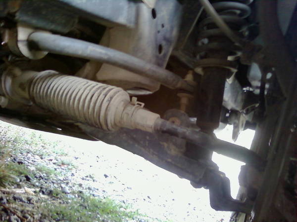

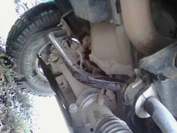

    Sorry to resurrect this thread, but it's probably better than starting a whole new thread.
    this long bar here is the sway bar right?
    and here at the end of the bar is the sway bar connector right?
  12. Aug 30, 2010 at 10:40 PM
    jdkeller
    jdkeller How many words can be fit in this s
    Nov 26, 2008
    #11040
    12,964
    Jonathan
    Inland Empire, Ca
    2008 Tacoma Prerunner TRD Offroad
    Dome light LED, 6000k HID Headlights and fogs, Grillcraft black mesh, rear 5100's, Total Chaos UCA's, 285/75/16 BFG KM2's, Spidertrax spacers, Blacked out emblems, cb,kenwood tm270 ham radio, All Pro 3" leaf pack, Fox 2.0 coilovers, Revenge Fab Sliders, u bolt flip kit, Pioneer avh4200, bed bar with light and antenna, Wet Okoles, Weathertech Mats, Wet Okole Armrests, Rear KR Fab bumper, bed mat, N-Fab spare tire carrier with full size spare on 16" TRD rim, Bedlinered flares and grille. Camburg Spindles, All Pro front fenders.
    Yes sir.
