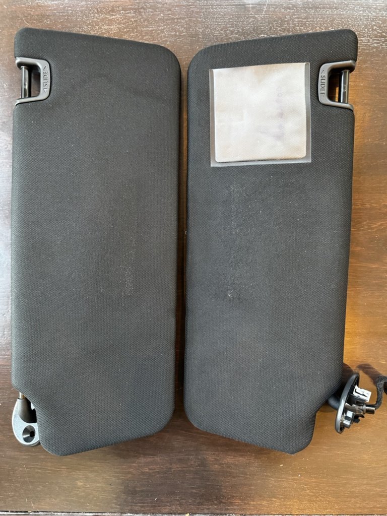

    Removed the drivers side "plastic sticker" like burntcremebrulee did on page 2 and like he said that 3rd sticker is invincible.
    Much better...

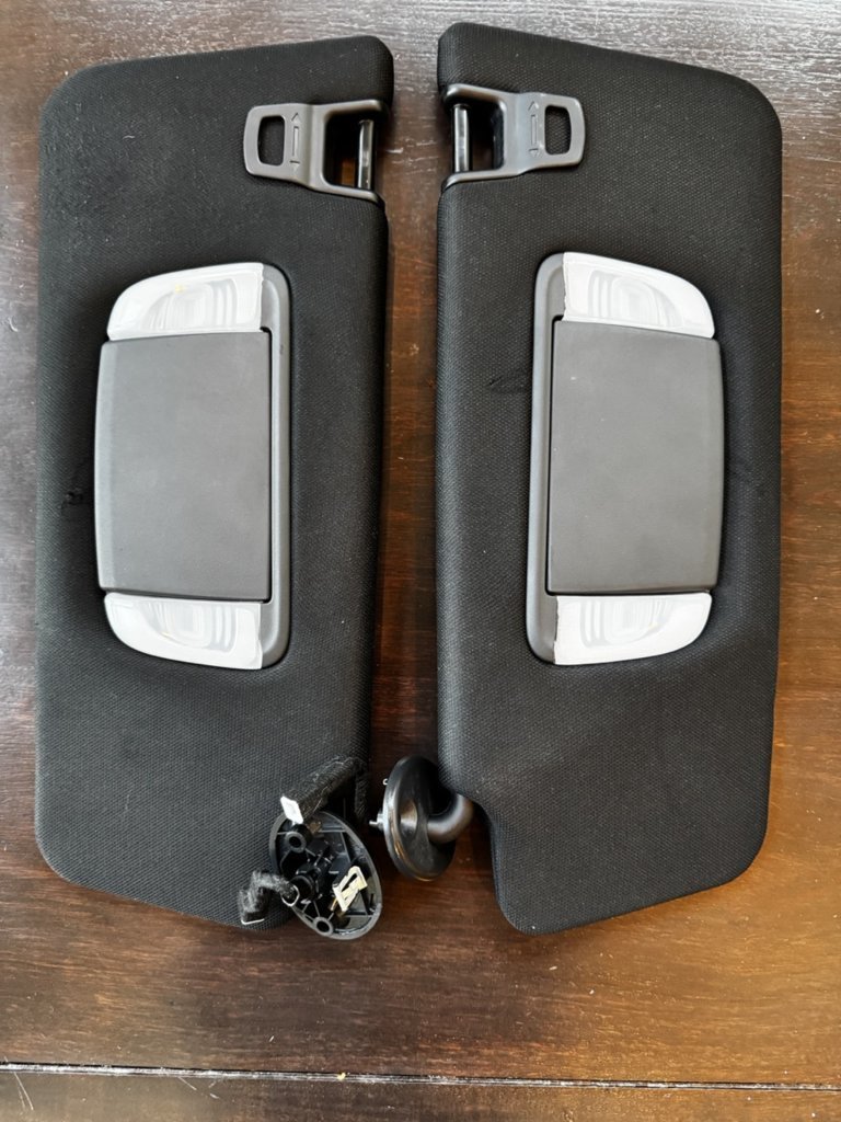

    I can't speak for older or newer generations, but if you have the same model as a 2019, please read:
    I landed here because I searched for "tacoma european spec sun visors no labels." This is because I spent the better part of the last week slowly trying to remove the 6 (!) labels from my visors only to discover that it is physically impossible to do so without causing obvious damage to the visors.
    I tried everything the Internet had to offer as far as DIY for this. Those things include:
    • 99% isopropyl alcohol
    • Acetone
    • Goo Gone
    • WD-40
    • Steam cleaner
    • Pressure washer
    I'm sure this has all been reported before, but I like to complain.
    If you are considering trying this, I urge you to reconsider, and guarantee you will ruin your visors.
    Some things to consider if you insist on trying like I did:
    • The "labels" on the mirror doors are not labels or stickers; they are painted on.
    • If you soak the ones glued to the fabric in isopropyl (>=91%), the sticker will come off, but the adhesive that held it on will not. That will take you several days of work, and some of the adhesive is just permanent and can't be removed. It's part of the fabric now.
    Honestly, after trying it myself, I am convinced the best thing to do would be:
    Take the visors to a local upholstery shop and have them remove the fabric and re-wrap them. I would then mask everything off with painter's tape for the mirror side and spray paint the mirror door in a matte black or dark grey. I don't think you would be able to tell there was anything there before.
    As for the stickers on the fabric: if I had another one to experiment on, I would go with the steam cleaner first (or a heat gun) and see if the adhesive would come off with the sticker. If it doesn't come off, you have to scrub it enough to ruin the fabric to get it out.
    Anyway, godspeed if you try it. I guess mine are going to an upholstery shop.
    This is the best I could do (I have OCD so they are trash now):
    jmneill likes this.
