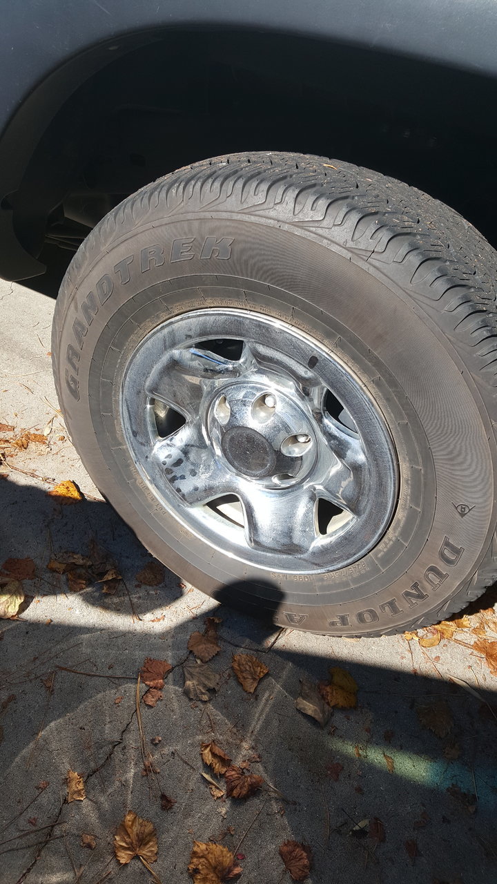

    Hey everyone! New to the tacoma fam, just bought a 2013 RC 4x4. Just wondering if anyone has any advice on how to remove the chrome wheelskins seen on the tire in the picture. I dont really want to break them but i think they are tacky looking. Help!

    Probably held on by the lugnuts. Have you tried looking to see how they're attached?

    Some dealers put those on to pretty em up before they sell em. We see them on CRV's and Ridgelines at the Honda dealer I work at...
    I think they sorta just clip around the spokes on the back.....but wouldn't surprise me if they are gonna break coming off no matter what.

    They snap on around each spoke, i was hoping they would just come right off but i think i am going to have to break them, i like the look of the 5 spoke steelies.

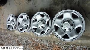

    I believe this is what the wheel under the plastic looks like.

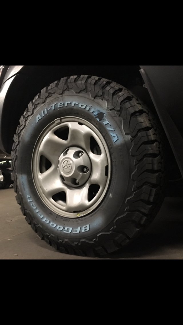

    Just gently pry em off with a screwdriver - slowly work around the edge popping the plastic clip tabs.
    Normal stock steelies underneath.
    If ur just gonna throw em away once off like i did, no need to be so gentle. Takes 2 secs

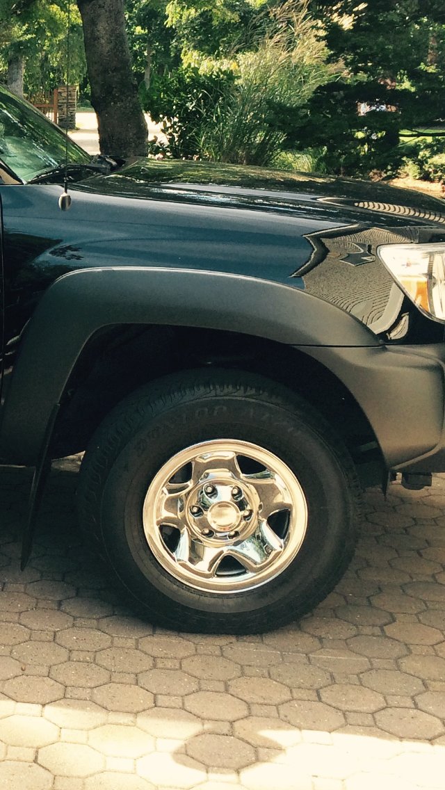

    Hm i dunno.
    Mine were cheap plastic skins. Attached by several clips.
    Look exactly the same as OPs.
    Before and after
