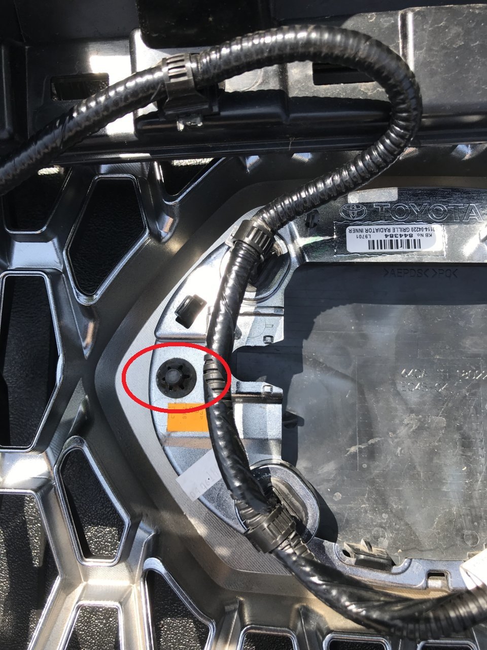

How do I remove this without breaking the post?

    It's the keeper on a post on the back of the Toyota emblem that covers the TSS.

    Is it metal? Did u try unthreading it? If not bend the fingers up.

    In the past I've use a die grinder to cut a small slit and remove it. Worked on a Lexus emblem and was able to reuse the clip after. Dabbed superglue as a precaution on reinstall.
