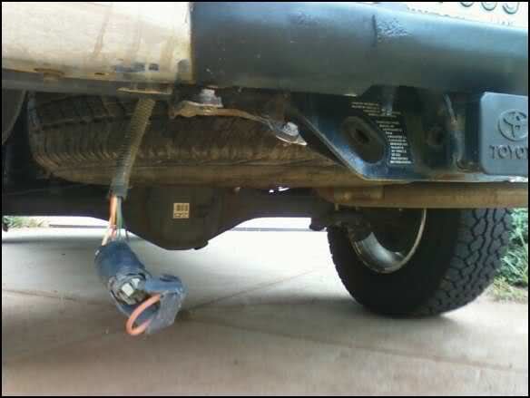

    Anyone else broke the receiver plug? Do I have to order another one from toyota?

    A whole lot,But not satify
    I saw some of those at Uhaul Rental they got a bunch of those,probably cheaper that the Stealer. just my.02

    look under cheap free mods to find a differnt location for your new plug. there are step by step instructions as to mount the new plug in the plate light hole or drill through your bumper.
    this is the worst thing about these trucks IMO. I bent mine up too but luckliy the plug was still good. I would check parts store or junk yard before i went to the dealer for this part.

    alright, thanks guys. Junk yard sounds like a good idea :D

    mount the new one in the bumper.

    Let me look in my garage.
    A while back I've replaced main with new one next to the license plate.

    mine didnt bend the plastic just broke that held it on but its stilll usable so i just zip tied it to where you cant see plus i dont tow

    Got it, The bracket, the plug like brand new.
    What's a good price? maybe $30.00 shipped?

    I broke mine a while ago and fixed it with epoxy and epoxy putty. I had all the broken parts though, I don't know bout you ?

    you can also go to autozone or someplace like that and get a new plug
