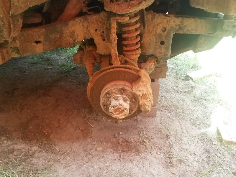

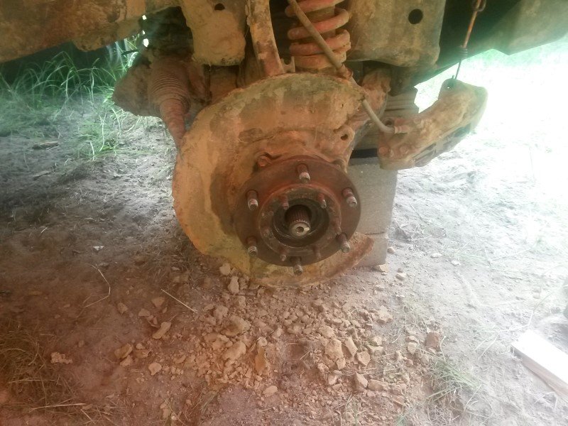

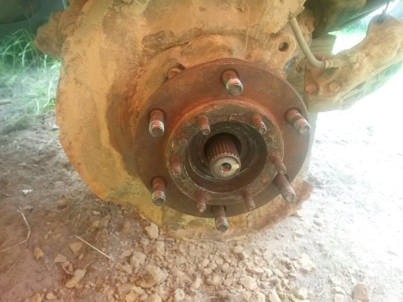

    A lot of the videos and pictures I found talk about a castle nut. My front end does not have a castle nut.
    The rest of the videos and pictures show 4 bolts that hold the wheel bearing housing in place. My truck does not have 4 bolts.
    I am going to guess I take the arms loose and then take the brake housing off?
    Are these bearings supposed to be pressed in?

    The photos you've shown are of a manual locking front hub. I was not aware that 1999 Tacomas had manual locking front hubs. My 1998 does not.

    ADD was an option (over manual hubs) up to 2000. Beginning in 2001, manual hubs were dropped completely.
