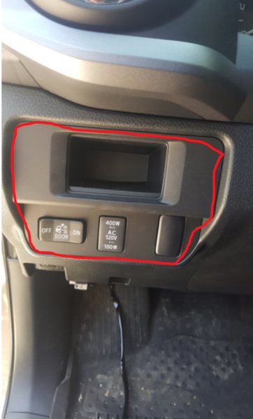

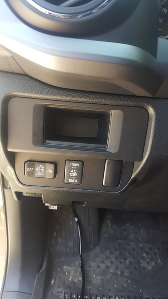

    I want to put a switch in that blank spot but not sure how to take off that part of the panel

    The whole piece circled in red pops off. insert a small regular screwdriver and just pop it.Screen Shot 2016-07-07 at 2.35.39 PM.jpg

    You should be able to reach under the dash and just pop that blank spot out and throw a rocker switch right in place.

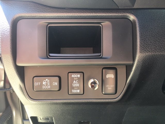

    Does anyone know the part number to this cubby? I need to order a new one.

    Carefully wedge the corners loose with a flathead, then stick your hand in the opening, press down and pull outward. It will pop out. Not too hard to accomplish.

    Go to harbor freight and get a set of plastic trim removal tools. That way you won’t scuff the dash.
