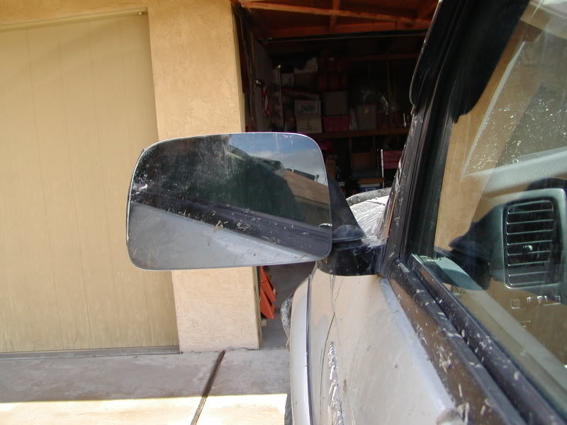

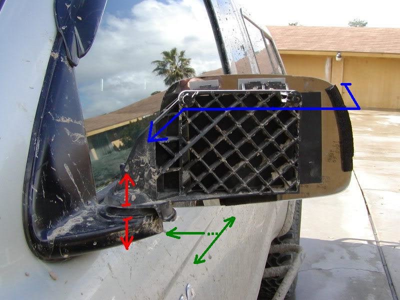

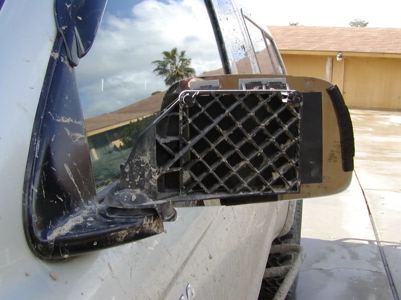

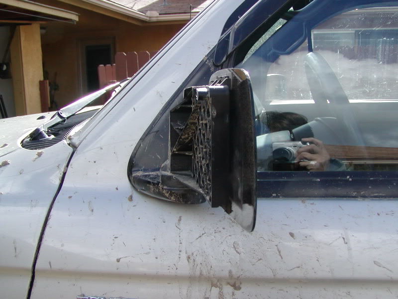

    Yep just double sticky tape holding that glass...
    I believe you must first remove the facia/retaining ring off the plastic housing.
    There must be a trick to it... but I don't know what that is.
    I do know there are little tabs that hold that in place.
    I know.. because I saw those when mine exploded.
    Most replacement mirrors(glass) I've seen...
    have terrible imagery and view more like a fun house mirror.
    So make sure before you go to all this trouble...
    yer locating a quality mirror/glass replacement...
    In all honesty... even after you figure out how to remove that plastic retaining ring of the mirror housing...
    You'll probably still have to break the glass to remove that from it's bond
    of the sticky tape... The stuff sticks very well
    I just bought a used mirror of ebay and called it good ;)
    Be careful about buying whole single or paired OEM replacements...
    or you'll end up with the fun house mirror effect as well.
    Here at least you can see some of the internals :p
    I bumped my driver's mirror into a boulder...
    and the plastic housing exploded...
    but the mirror(glass) was still intact
    I left it like that for a few months before replacing it...
    Even pressure washing's and the SW heat didn't loosen that bugger.
    I had this extra cover tho'
    so it looked good when it was parked :D

    So I was fortunate enough to receive a broken mirror in the mail which triggered my attempt to install those heated pads (for motorcycle grips) behind the glass and run the wires to a switch in the cab.
    However, being a numbnutz, I have encountered a couple of issues.
    After removing the snap ring/fascia thing I was able to easily remove the broken glass from the 4 or 5 little squares of double sided adhesive.
    Then I was able to at least loosen that honeycomb backing plate pictured above.
    My question is if I adhere a heating pad to the back of the glass, how do I run the wires from the back of the glass and into the cab. I would like to have the wires go from the mirror housing down into the door and through the rubber pass through that enters the cab next to/behind the dash.
    I just don't see a way from behind the mirror to the door. I don't mind drilling a hole in the inside of the mirror housing, I just have no idea if it'll work.
    I also can't seem to separate the mirror housing in half like pictured above.

    The housing can only be separated if the nut or screws securing the mirror to its base are removed...
    Mine is separated in the above picture...
    because it exploded apart after nailing a large boulder.
    Oddly... the mirror glass didn't break.
    I think there is also a single screw on the inner side of the housing that needs be removed in order to remove the outer housing.
    It's been awhile since I took one apart...
    so my detailing might be a little off.
