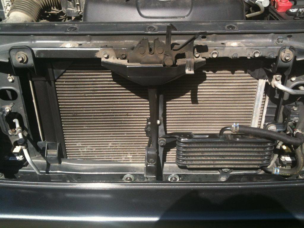

    ^Photo by OZ:

    Paint that rad !

    ^^^This^^^^ Just give the parts counter guy your VIN number he can print off a vehicle inquiry report. I did and it told me everything my truck was built with, including if it was fleet or non fleet.

    Easiest way to tell if you have the factory tow package is to look for the engine oil cooler. Round can below the oil filter with 2 heater hose sized hoses attached to it. If you have an automatic, it would also have the factory transmission oil cooler.

    I would bet it does. I have the same set up from the factory. Just pop the hood and look for the little trans cooler in the bottom right of the radiator. This pic is from another member.

    Thanks for the info guys. I always thought I had a aftermarket setup (ripoff) from Larry H Miller but turns out it's a real Toyota towing option. Who makes the big red oil filter?

    Don't know. It's just a pic I found with Google image search.
