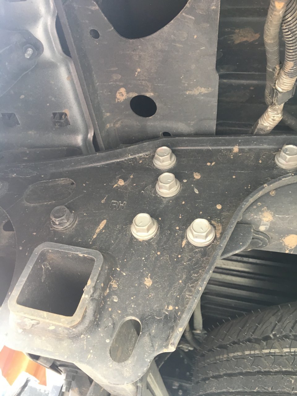

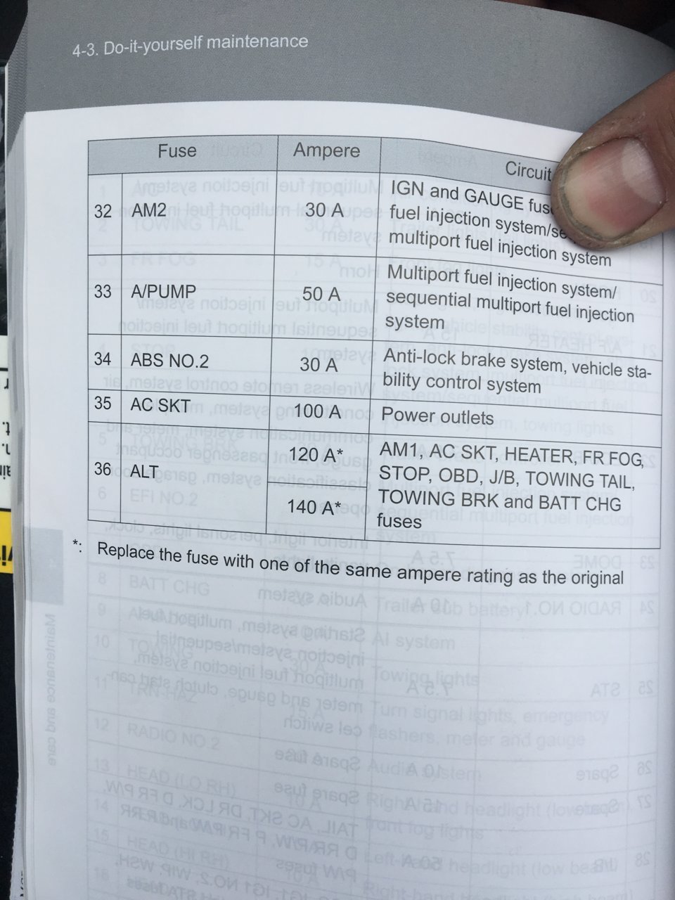

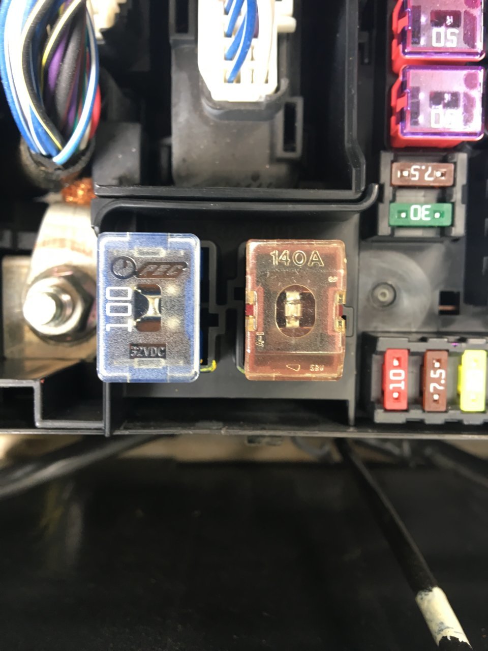

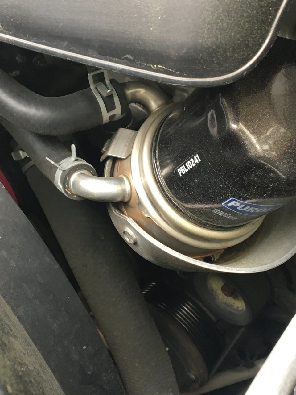

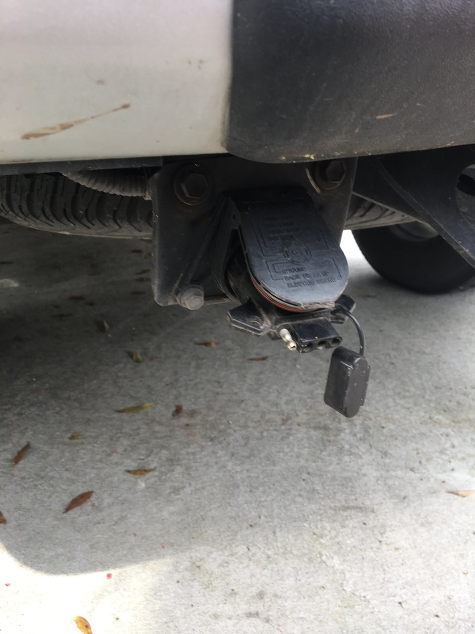

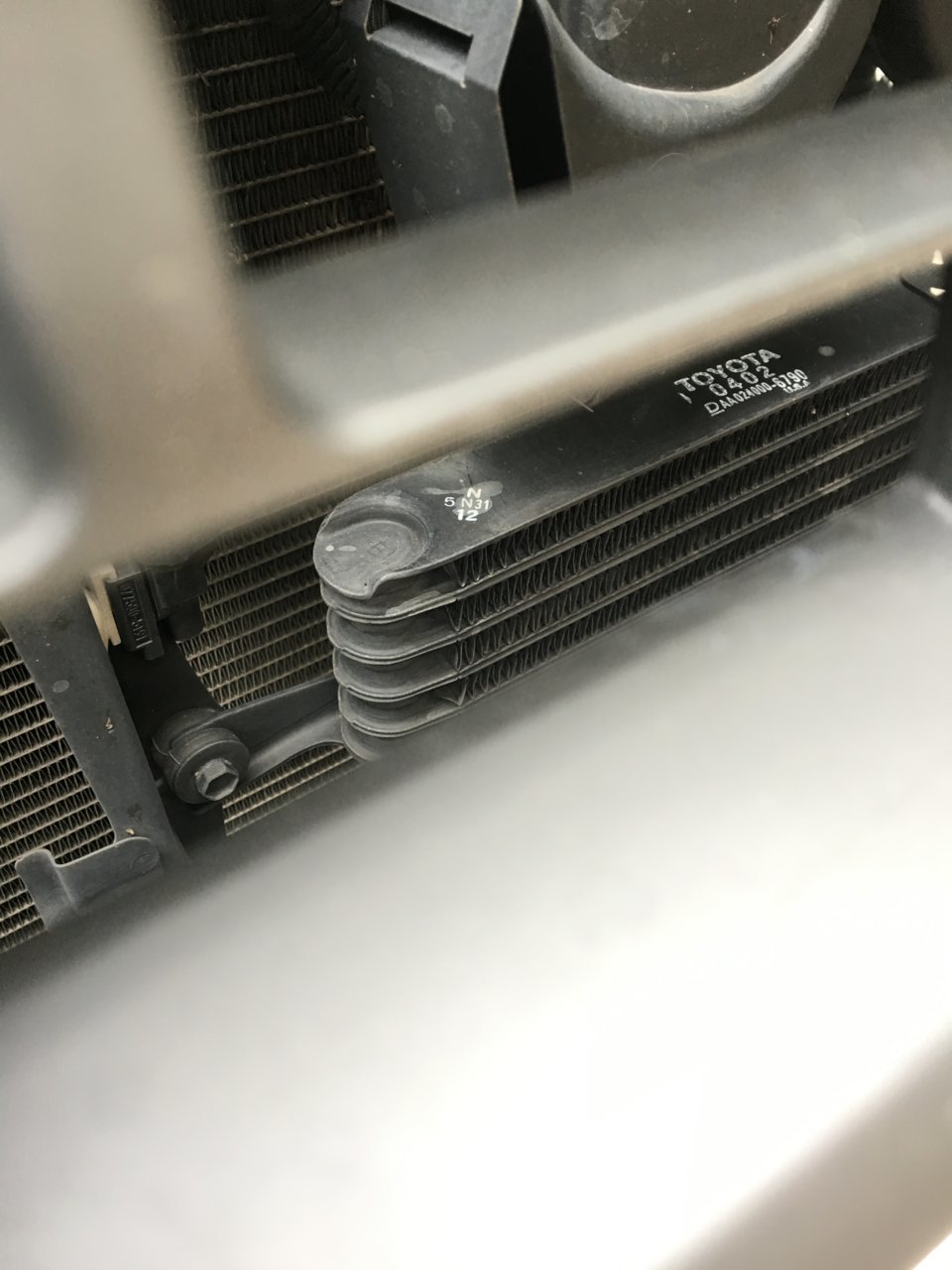

    This is how my 2012 TRD Sport is set up. Called the dealer to confirm factory tow package.
    Owners manual says either 120A or 140A fuse, I’m assuming on your package.
    Trans cooler
    Oil cooler, you’ll see the lines routed near where the upper radiator hose attaches to block.
    Round connector
    This is how my hitch is bolted to the frame.

    All of those photos are parts that are part of the factory tow package (not sure about the 4 pin adaptor you have stuck in your 7 pin trailer light socket), and would not be present on trucks without the tow package.
