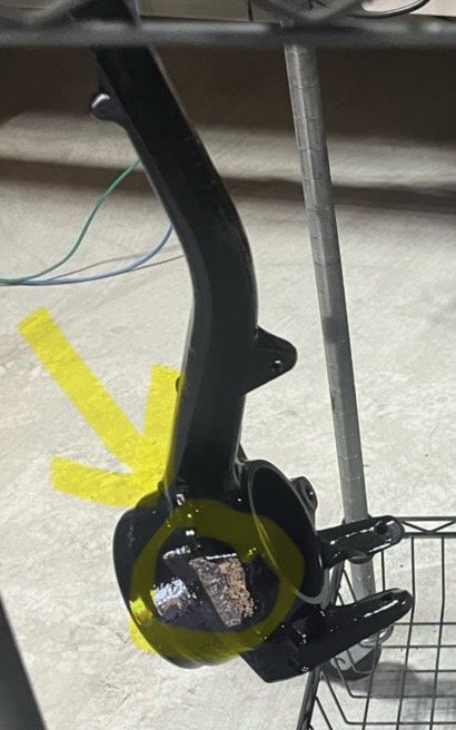

    Look here on your front knuckle. Inside the yellow circle is a flat spot in the casting. This is a NON-ABS knuckle. If it were ABS, there would be a hole there where a roughly 5/8” sensor plugs
    into on both the knuckles.

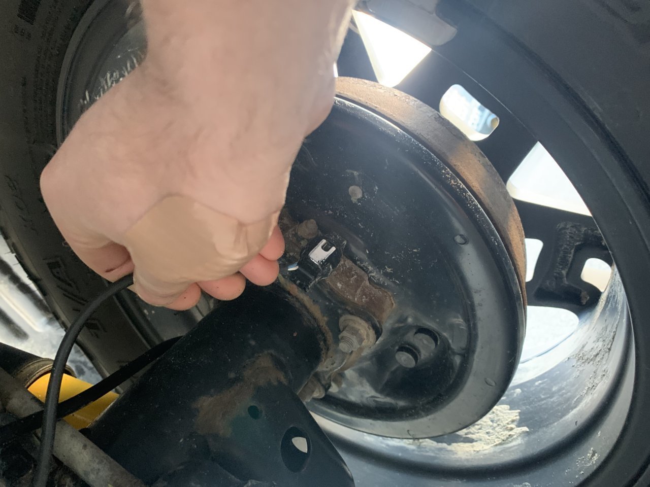

    Look right behind your backing plate on your truck. If there is a little wire plug coming down into the top of the axle right next to the backing plate, you have ABS. If there is no electrical wire or empty plug, you do not
