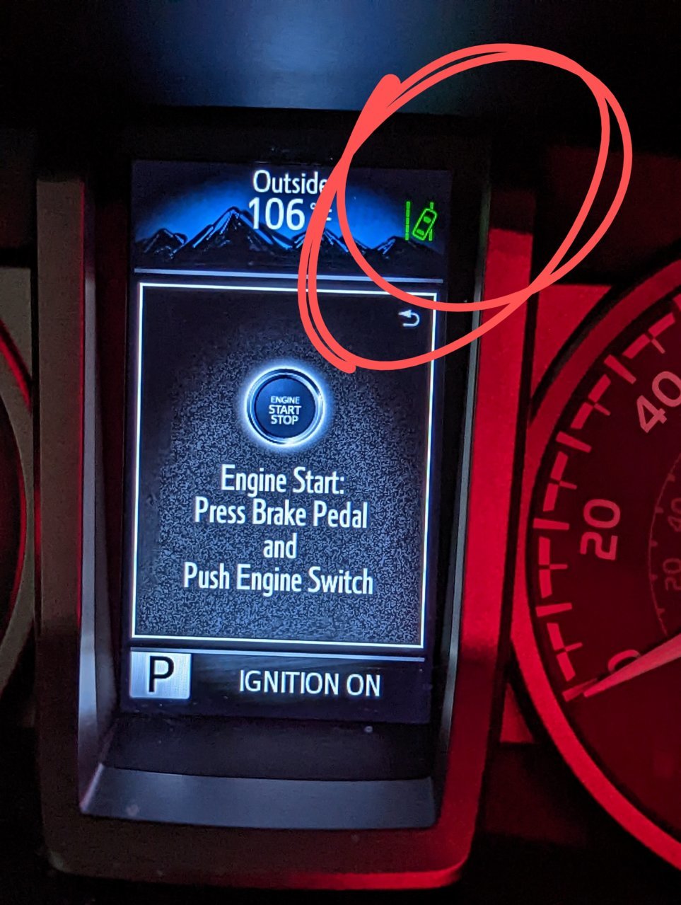

    Hmm, so today I turned on LDA, and on any of the three settings of sensitivity, there is no alarm when I tried crossing over the line. My wife's Subaru detects lane egress very well. I couldn't get the truck to trigger a warning. I also did not see a green symbol on the cluster indicating it was enabled when in the info display in the middle of the console, it's turned on.
    Oh no!
    How might someone with the function who has it enabled suggest I test the function. I'm not sure I can even do that if the function doesn't show enabled on the cluster with the green icon.
    Tomorrow, I'll take a look and see if I even have the camera which should be behind the rear view mirror.

    The indicator should be on whenever LDA is turned on. It should default to on whenever you start the truck. Make sure this is on before you take it out of park.

    OMG...the button is on the steering wheel. I press the button as I am driving...like I do for DRCC when I'm on highway roads.

    OMG - you win the prize! How crazy to have a couple of interfaces on the Multi-function display, one telling you it's on and allowing you to adjust sensitivity (but it isn't really on - I think just enabled) and another telling you it's off.
    Bad usability engineering. Bad!
    And then to actually turn it on, you have to use the button on the steering wheel... What an idiot I am. Back under my rock I go...

    It will make a really annoying beeping sound if it’s on so you can’t miss it. It’s the bottom button on the steering wheel don’t confuse it with the cruise control button that’s what I did at first
