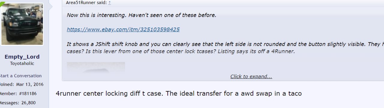

    Here is what I remember seeing. It wasn't a 2-4 button but the 4WD button.

    yeah I think those are the somewhat uncommon shifters off the full time 4wd 3rd gen 4runners with center diffs. Some people have talked about doing that swap on their 1st gens.

    I think it was just some of the Limited models? Definitely not all of them, most were just part time 4wd like ours. Or maybe it was a model year thing. @Kwikvette probably knows

    Only for 2001 and 2002 models.
    When you put it in 4WD/4HI it's basically AWD. Again only for 2001-02 4Runners regardless of trim as it was standard equipment.
    Once you push that center Lock button (where the rear diff lock sits on older 4Runners or TRD Tacomas), it locks the center and now it runs as any actual 4WD truck does.
    Multimode had the same concept, but those transfer cases were an 'option' and not standard equipment by any means. They were also found only in 1999-00 models.
    Bivouac and eon_blue[QUOTED] like this.

    No but the recent discussion above regarding the center lock (and even the picture of the shift knob) is specific to the 3rd Gen 4Runner.
    Not available in a Tacoma.
    Sucks the 4Runner did away with the rear locker for the last 2 years of the 3rd Gen.
