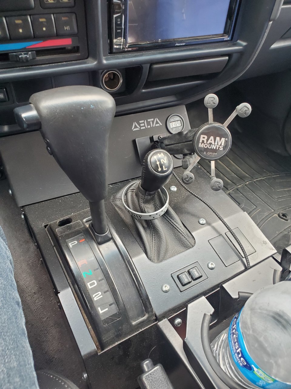

    Now if only I knew how to turn off my 4x4 :anonymous:

    80s series are in 4x4 beast mode even when they're not in 4wd
    Kwikvette[QUOTED] likes this.
