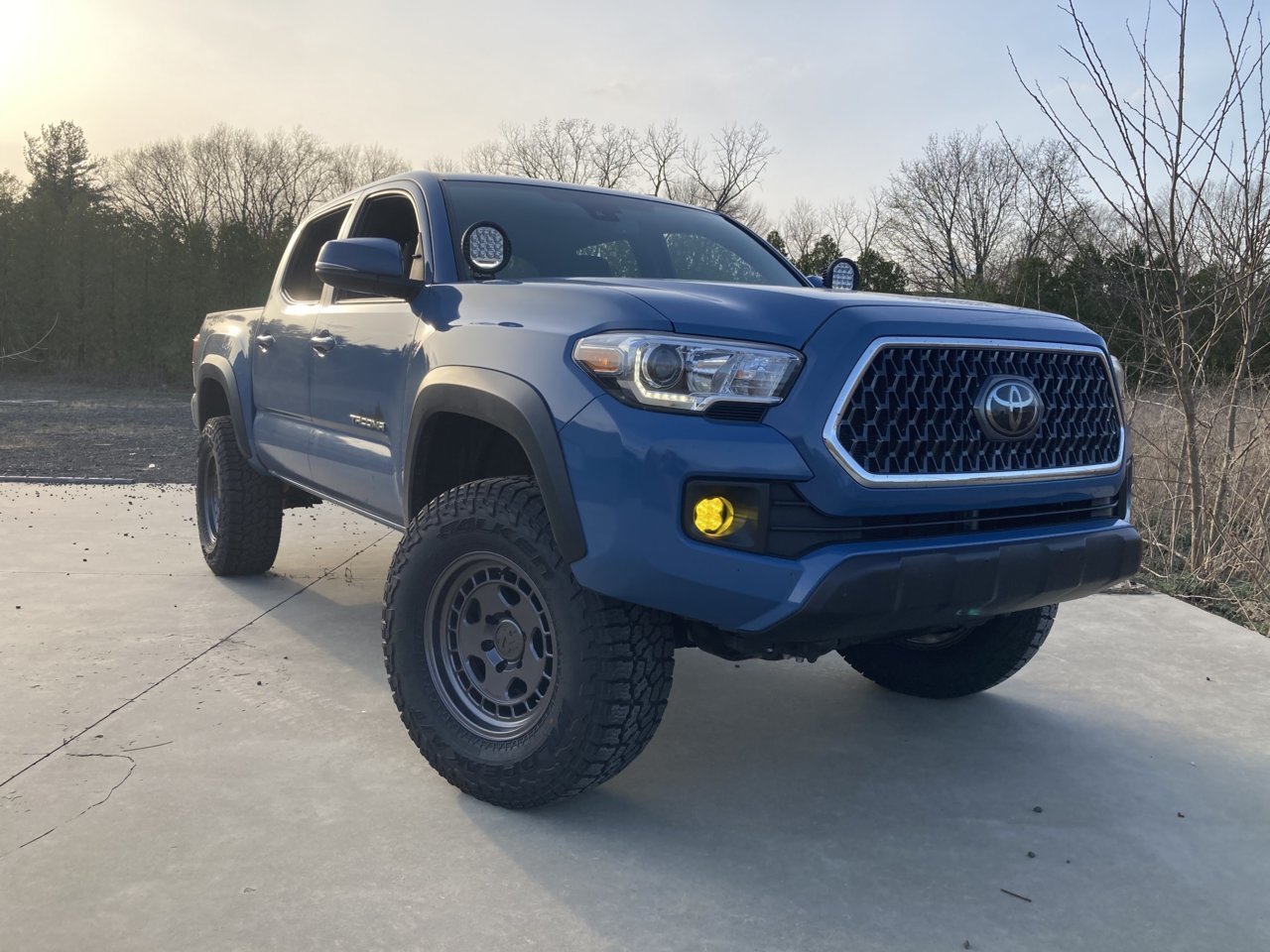

    Nice truck I'll try with ought spacers and see if that works

  3. Apr 4, 2022 at 4:23 PM
    #23
    splitbolt
    splitbolt Voodoo Witch Doctor
    Mar 7, 2010
    #32761
    7,858
    NW Arkansas
    2016 TRD OFFROAD DCSB MGM
    +30mm offset with 1.25" spacer puts you at -1.75mm offset

    I can get the chop for 350, lol. Spc are good if you have decent shop to set them I don't trust any in my small town though. Probably end up with even more issues. Plus the freedoms are very tuff.

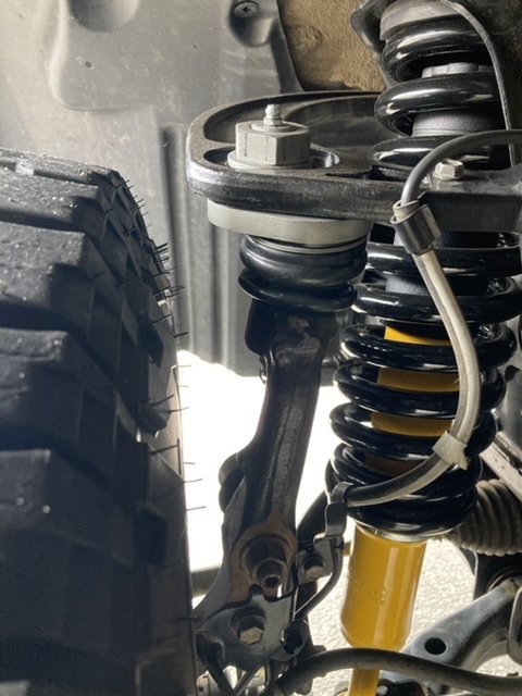

    Trd stickers for 10whp 32s on MK6 17s
    The control arms move the ball joint to get back to original specs which cause the tire to rub the firewall/cab mount. Every static aftermarket UCA has this issue. They give you lots of caster back but unfortunately you lose clearance at the cab mount.

    Yeah chopping will work but if you ever go larger you will want them. And I'm telling you. They would be enough to clear without a chop. Mine clear fine with stock UCAs. The adjustables just give even more clearance. The key when using the adjustables are you can literally max out the LCAs for maximum caster and then fix the camber at the UCA that can't be done with static arms.

    I have ~ 2 inch lift with 285/75/16 with 1.25 spacer. No rubbing after removing the front mud flaps and minor plastic trimming. Stock wheels and UCA. I’ve taken it off-road 4 times so far.
