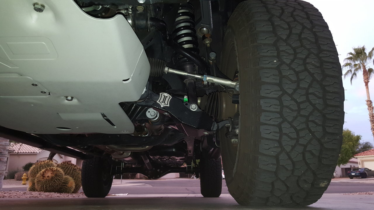

    Here are the angles with the camera leveled. Also my Icon setup.

    @Dacon nice. Your outer boot fins look similar to mine. Cant tell on your inner boots. Do you know if icon and King turn to lift ratio is the same? I'm getting a slight vibe between 20 mph and 30. I'd I'm accelerating through that range it doesnt really vibe but if I'm coasting through it vibes more.

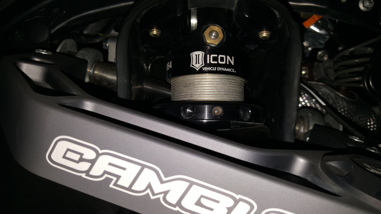

    Not to get side tracked but did you adjust the coilovers while everything was on your truck or did you remove it, compress the spring and adjust it? I'm asking because I have 7 threads showing on each side and my suspension also settled and I think you have the perfect amount of threads showing.

    I am not the OP, but I jacked the truck up to get all the weight off the tire and did it with coilover on the truck. Using a 5/16" punch, it was easy peasy.

    No problem. I was abbreviating the instructions. If it is not obvious to you that you first loosen the allen bolts on the retainer ring, then do that first. Also, on these trucks, a general rule of thumb is that it is slightly less than a 2:1 ratio of incrased thread showing to lift on the truck. In other words, if you add 1" of thread you will gain slightly less than 2" of height. Also, I am not a fan of counting threads. Before you start, measure from the bottom of the reatiner ring to a fixed object above it to see how much thread length you have gained. That should get you in the ballpark of where you want to be.
    Alsdo, if you have reservoirs, you will have to loosen the fitting to the hose in order to turn the nut. To loosen that nut is ok. DO NOT do it so much that all your oil pours out. A few drops is probably ok, but be careful as you do it.
