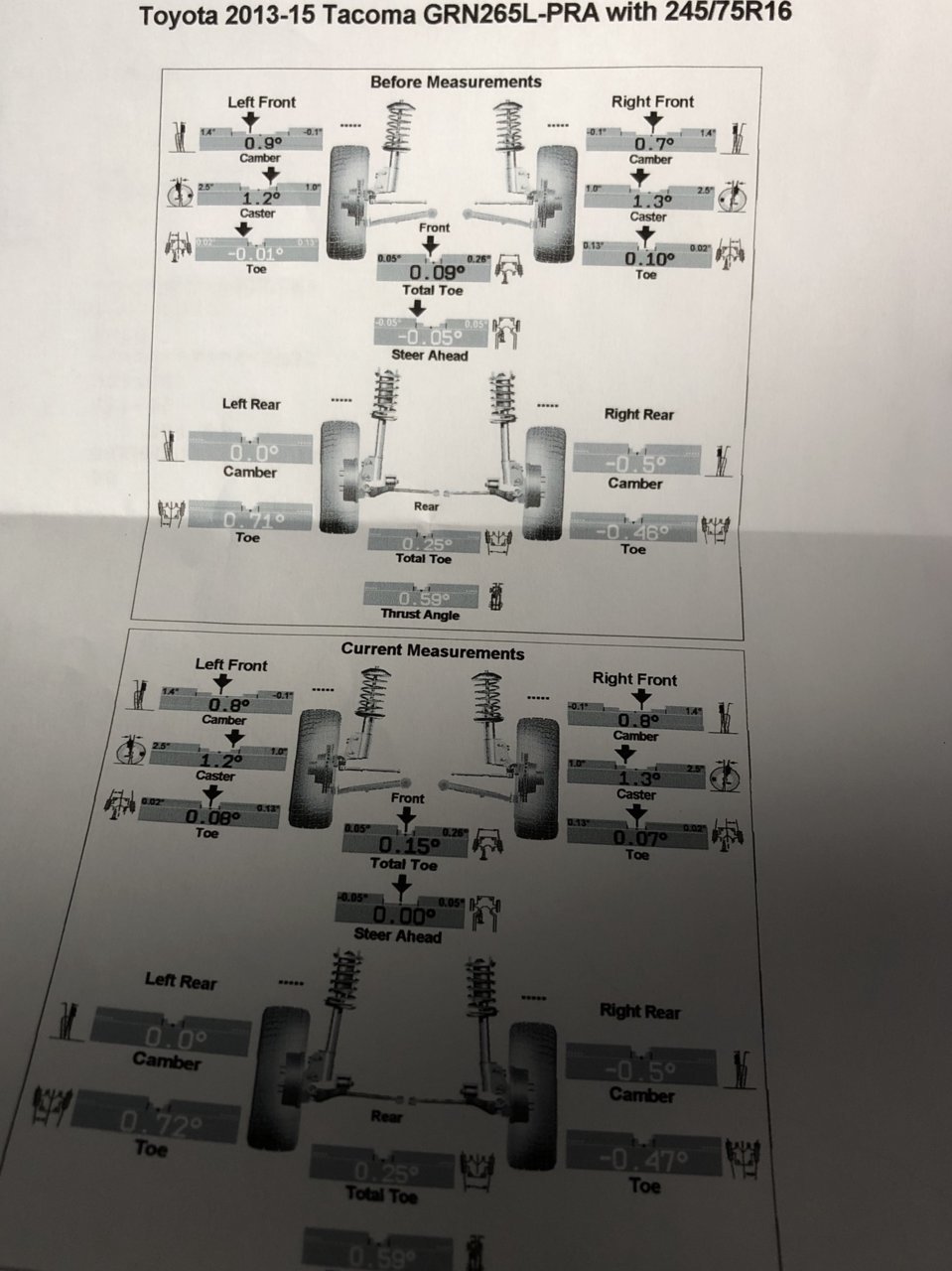

    So I have a 2015 Tacoma with 5100s on all fours, Dakar’s leafs, 887 coils and jba high caster uca. The before specs are a day after install, which is why everything was out of wack. And I drove for a day to let the suspension settle before going for an alignment. How do the current specs looks.

    your after specs look good, kind of depending on your tire choice. firm tires don't like camber variations like that but probably not an issue for you unless you run smaller size E range tires. anyway, go enjoy!

    Awesome thanks. Still deciding what size to run, but I’m going with falcon wildpeaks. 285/75/16 or 265/75/16 for weight reduction.

    As my dad would say, “good enough for government work” :thumbsup:

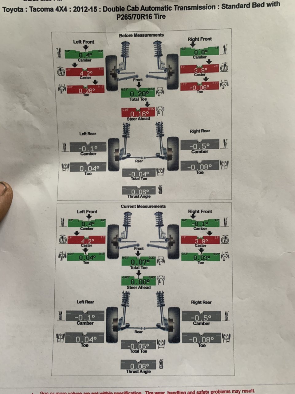

    Lol did you make this thread just to flex on us? Here’s my alignment...
