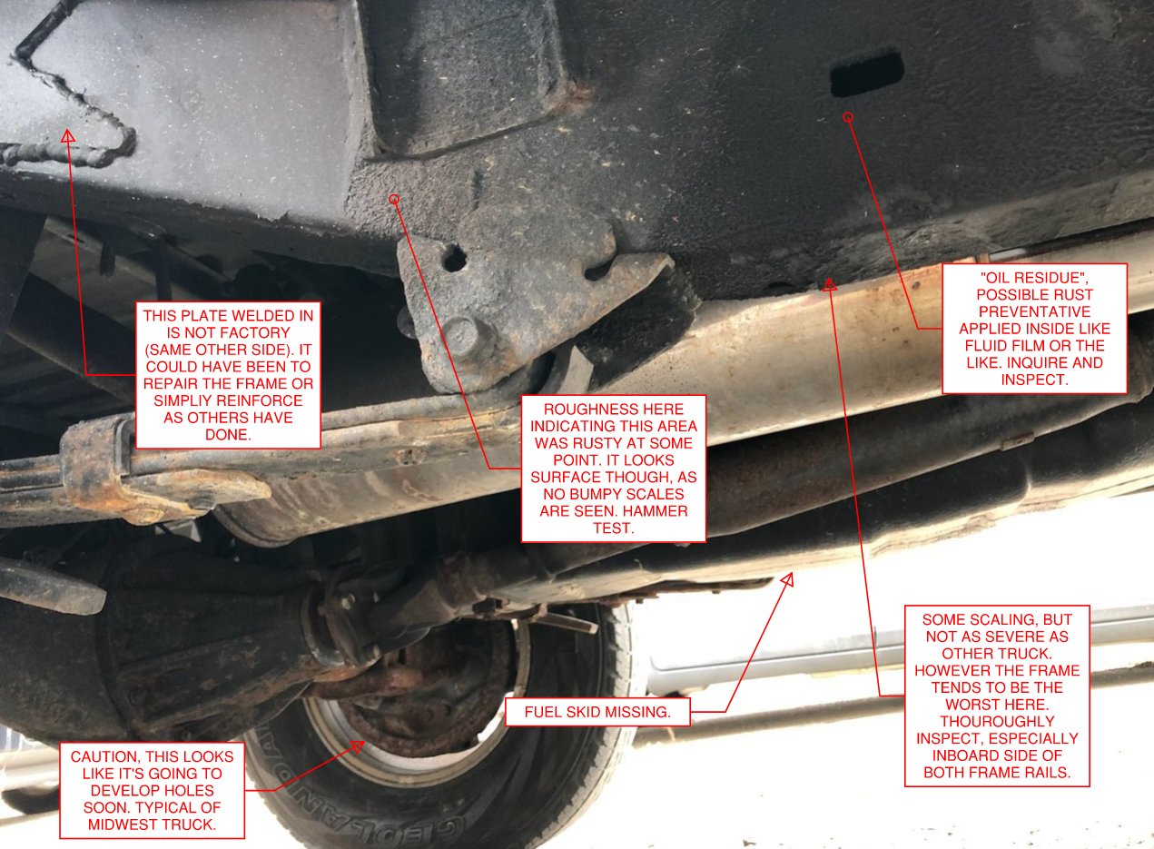

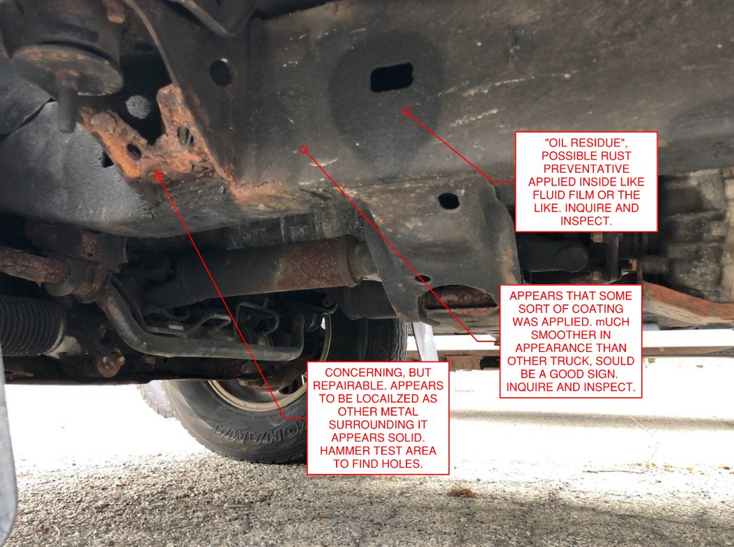

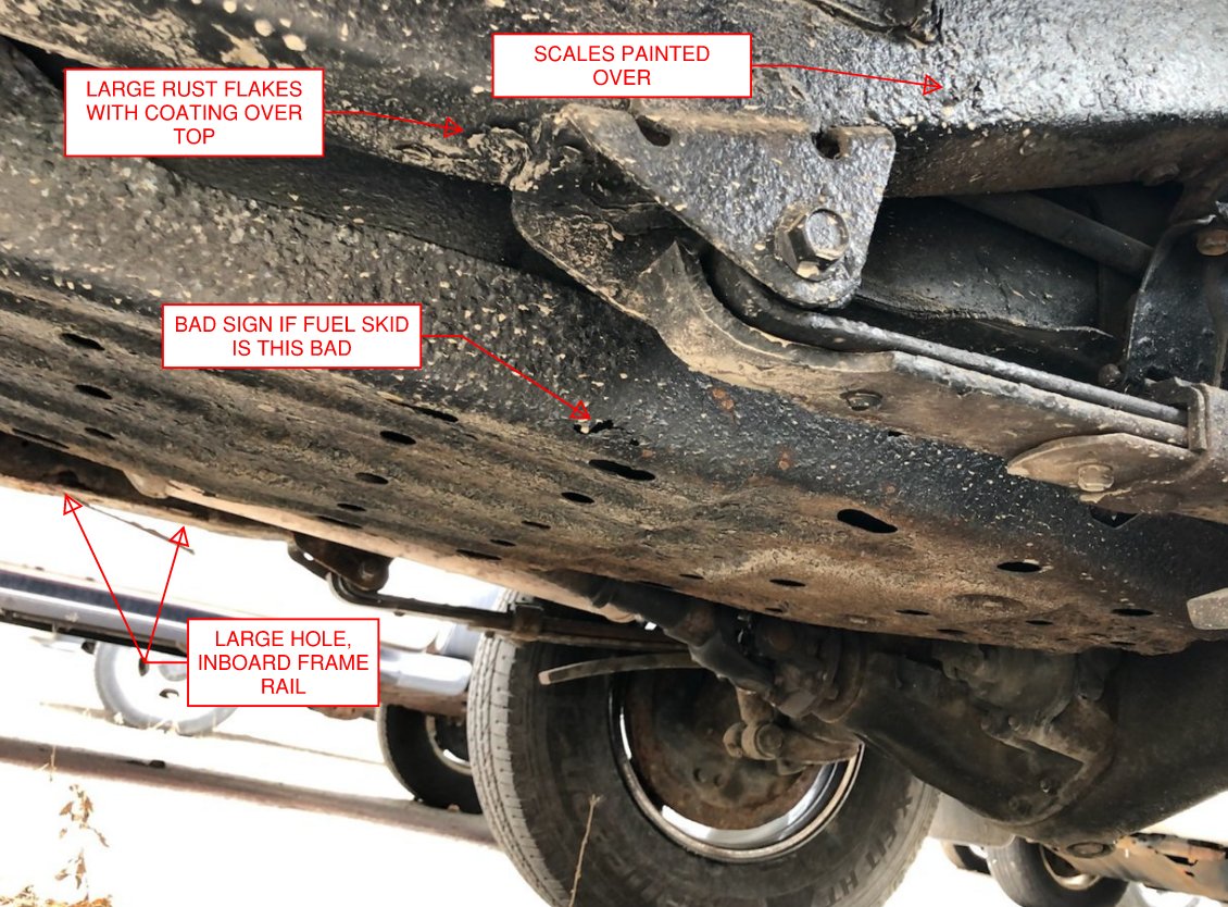

    The '04 Tacoma - Undercoating is not necessarily a sign of a bad frame. Many folks on this forum have had great success using undercoating (Never, Never, Ever the rubber stuff though) such as POR-15 to preserve frames that already have rust. That being said, it's all about the prep work. This involves alot of labor knocking off the rust scales/flakes and getting back to the base material under it all. Basically, the only rust should be surface level when you actually apply POR-15 and great care must be taken to ensure the surface is free of grease/oil/grim before coating. Ideally it is topcoated in areas exposed to sun. The 04 looks like it had zero prep work, flakes already look like they are falling off. Rust is showing though the undercoating. The passenger side rail looks like it took a large impact as evident in your second photo of it (you can see a bend). I would suspect the inside of the frame to be much worse. I would pass on this, whoever did it put in the bare minimum.
    The '03 Tacoma - It has some concerning spots (like the cab mount), but overall looks to be in better shape. It was already patched and/or reinforced in the rear (you can see an aftermarket plate welded in on the rear section by the rear axle. See my comments above regarding the undercoating. Get more details on this. Do the hammer test all over as suggested by others. IMO, This one has some potential, but you better be sure its okay and/or comfortable with the repair work.

    Agree but would word it differently.. the first one isn't as far gone.

    1st one looks like it already has a hole in the frame above the leaf perches... just like mine. I guarantee if you take a screwdriver and poke it you'll blow right through the frame. This is exactly how my truck looked before I fixed it.
    2nd ones already been "repaired"... those welds look like shit. I'd avoid both trucks
    Edit: AND @Cattywampus spotted a massive hole on the inner frame rail on the 04. Good catch. These are both pretty bad...

    Hard to say. It really depends on the extent of the damage and your own standards for repair. If it is just the most apparent "angled plate", you could just fab a little piece to replace it and weld it in. Could probably be done for a couple hundred buck or a piece of steel depending on your skills. What I have found about rust repair, half the time the damage extends further than what is apparent. Replacing the entire cab mount can be done, but would cost $500+ if I had to guess because of all the parts, disassembly, and prep work involved.

    Whatever you see on the outside, assume it's 10x worse on the inside. Frames rust from the inside-out. That's where all the water, salt, and debris sits and can't easily be washed off and kept dry.
    As for the cab mount, it's just a few pieces of steel. Any fab shop should be able to make one up fairly easily. The problem is assuming that's the only issue. FIRST step should be a much more detailed in-person inspection.
    Also, as someone else already pointed out, the welds on those frame plates are, shall we say, less than ideal. Not saying I could do better, but I probably could, lol. And I'm a grinder, not a welder, lol.
    You really need to find out if those plates are there to repair rust, or were installed for general reinforcement (off-roaders do that commonly to stiffen the frame). If it was to repair rust, just walk away. Be patient.
