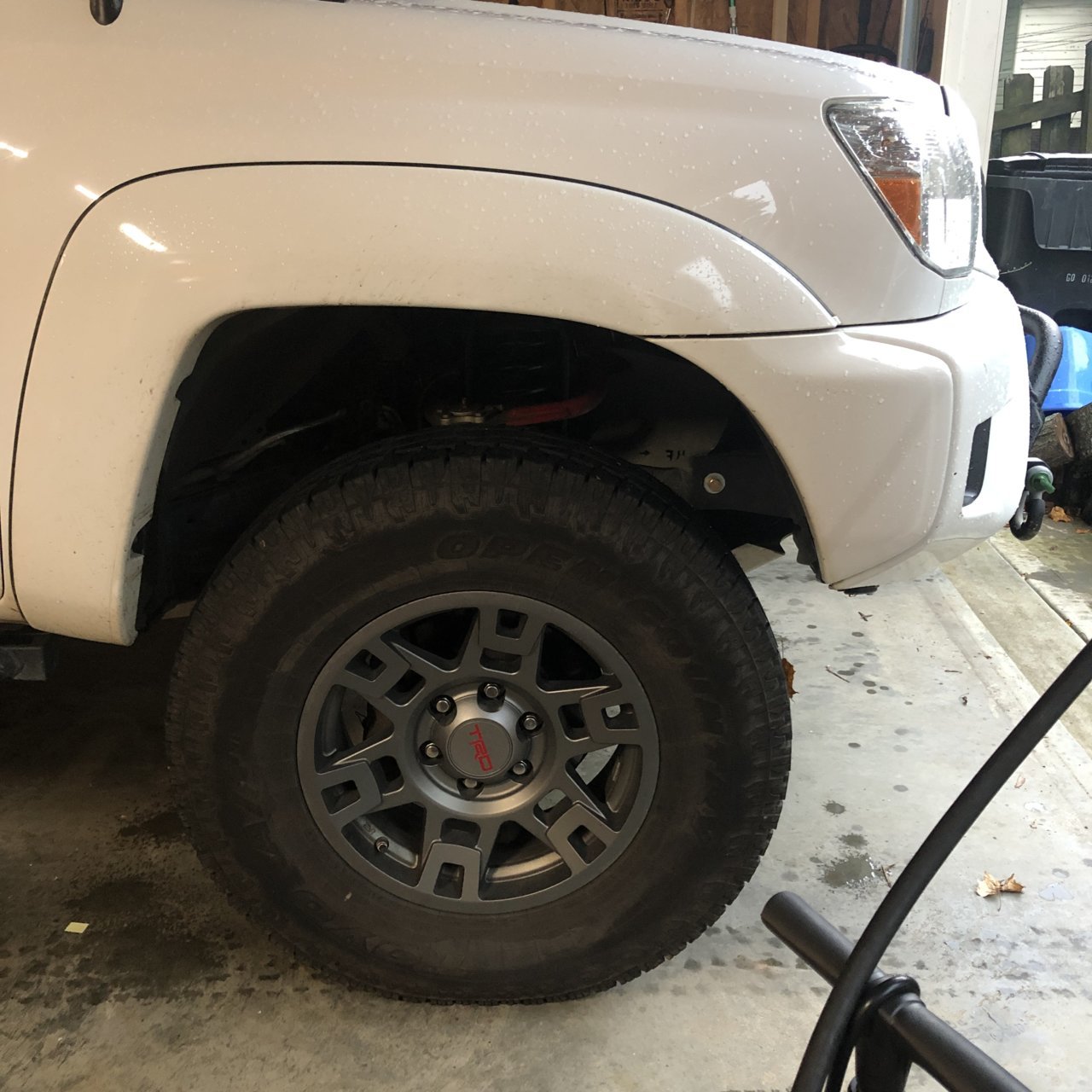

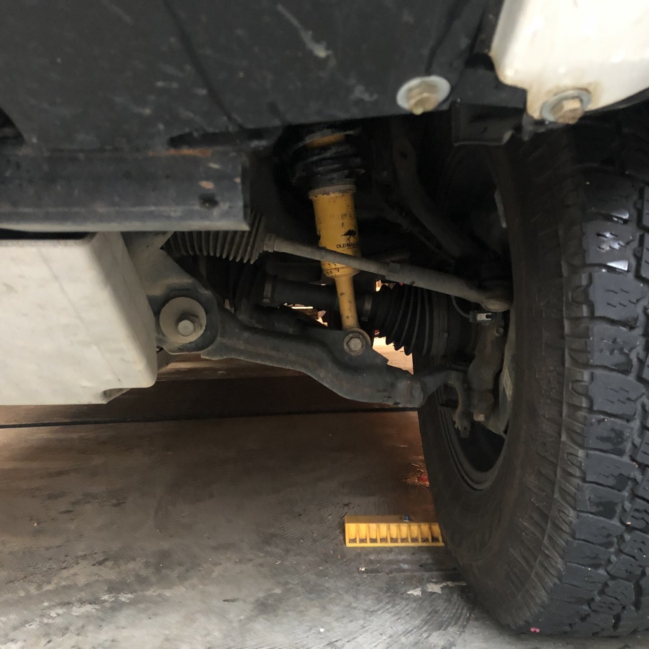

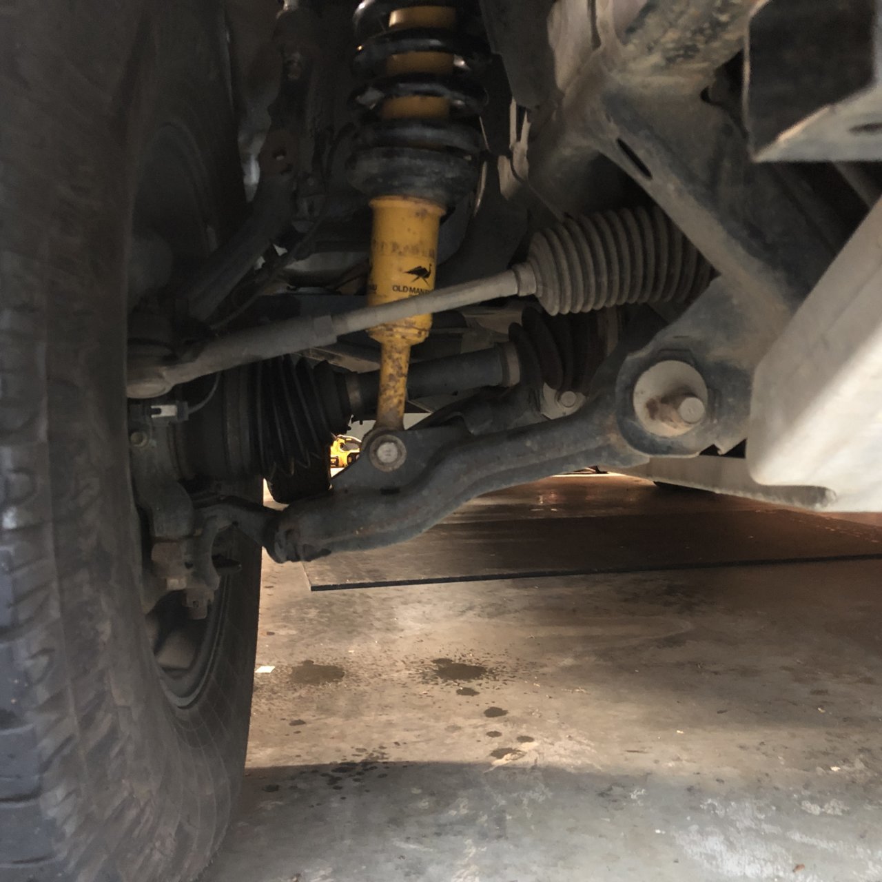

    885s(With 1/4” spacers) have been sagging badly so I’m trying out some 886s. What are y’all thoughts on these CV angles? Before and after hub center to fender measurements in last photo

    Ditto, looks legit.

    Ok. I looked back at my original, stock numbers, looks like this gave me a true 3” of lift. Was hoping for about 2.5” but I guess this will due until I can get some BP-51s. I’ll have to drive about 135 miles before I get an alignment, how bad will I F-Up my tires?
