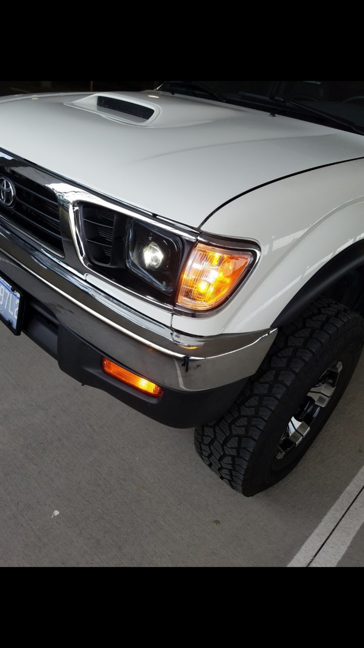

    I am wanting to add the turn signal mod BUT also keep the OEM turn signal in the lower front section.
    The OEM blinker doesn’t give an side visibility and the turn signal mod gives limited head on visibility because of the surface area facing forwards.
    Can a 2nd set of blinkers be just wired in, tapped into the original harness?
    Will the current load be ok?
    Fuse ?, will the relay blinker work? Or flash slower or faster?
    Or would LED replacement bulbs work better with lower current and a different relay,.?

    Ended up adding LEDS to the rear and 4 incandescent orange bulbs up front so my marker lights and the stock blinker lights work together now with stock flasher.
    I just tapped into the front blinker wire harness to add the 2nd blinkers.

    I ordered a set of those Lasfit LED bulbs for the front, hopefully they work.
    The normal LEDS dont work for the front

    They didn’t work!!

    So, because of my truck having a trailer harness it’s probably causing issues for LEDS up front.
    Im happy now with inconsistent, 4 bulbs for the front turn signals and 2 LEDS for the rear with the stock flasher.
