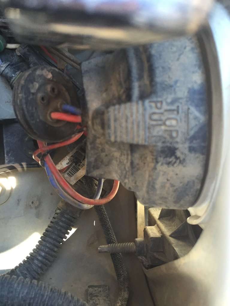

    Looking down at the headlight you should see the adjustment bolt. I used a 4mm socket and a 1/4" ratchet to adjust it.IMG_1494_870a31384981926c6aaa177da5df6f345aaab34a.jpg

    ok, I saw that thing, I thought I was looking at the back side of some headlight bracket screw.
    so I only get one direction to adjust? I assume that's the up or down adjustment

    Correct
