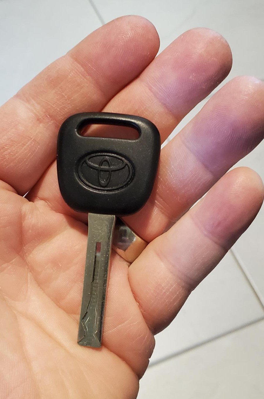

    So the large plastic headed mechanical key that does NOT come out of the fob only unlocks doors, nothing else?

    i don't know what you mean by 'not come out'. the blade key that attaches to the keyring(unless you have an upgraded case) is the mechanical entry backup.
    it can also be used to drop the truck into neutral after removing the square plug just in front of the shifter, as well as lock/unlock the tailgate.

    Yes, its intended for ease of use on the tail gate oddly enough. You can stow under the arm rest lid if I recall there's a slot to keep it there.

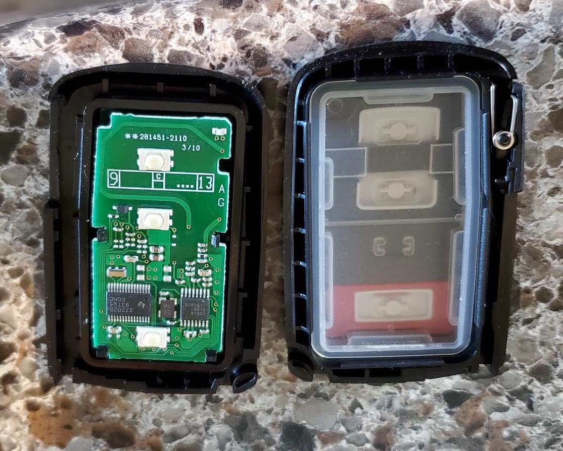

    battery?

    Lift out the green then pry out the battery 2032 coin style.

    This is the NOT come out of fob key:rofl::rofl::rofl:

    Okay, I was afraid to pop that part out...

    on the other side. lift the circuit board out. the black plastic clips are part of the battery retainer

    Okay, key opens door and fob against button started the truck:thumbsup:
    But I have "key not detected" warning and a "!" flashing too. It will still drive without shutting off?

    Yes will drive as long as needed, it’s worried you started the truck and left it outside the vehicle.
    again these are just secondary safe guards, it’s good to see how it all works
