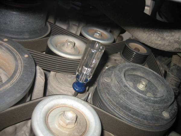

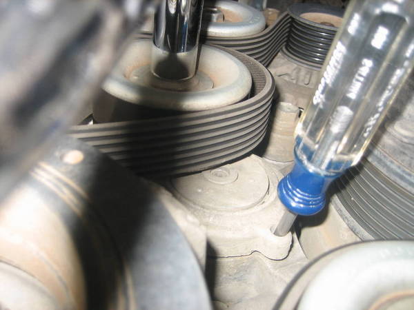

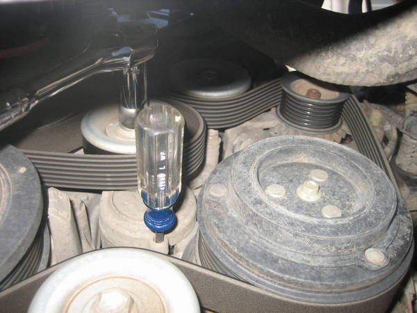

    Here are some pictures I took when changing my belt.
    In this pic I am using a screwdriver in the hole to hold the tentioner open while I remove the old belt and install the new one.
    Once the screwdriver is in, you can remove the wrench and install the belt.

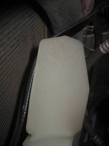

    You have to install the new belt between the radiator and the fan.
