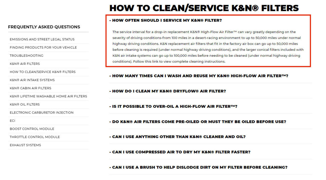

    I got one for my second Gen that was given from a friend. Don’t know much about it but I’m sure mine could use a newer one with 232k miles so I’ll install it. He told me how to clean it but I’m wondering how often I should clean it.

    Clean based on visual. If its red, its clean, black its dirty.
    Just shoot it with the cleaner, rinse with low pressure water, dry in the sun.
    Spray lightly with oil on the side facing the fender. No oil on the engine side.

    Everyone's directions are what I do (did). Sometimes I needed multiple washes before I would get it clean enough. I live in the desert and it would get DIRTY!
    That said, I don't use a K&N filter anymore. I had them on both cars and my XR dirt bike but never on the trucks. I would often find sand on the filtered side of the airbox so I've gone back to paper filters. They work well.

    From the K&N website, in their FAQ section.
