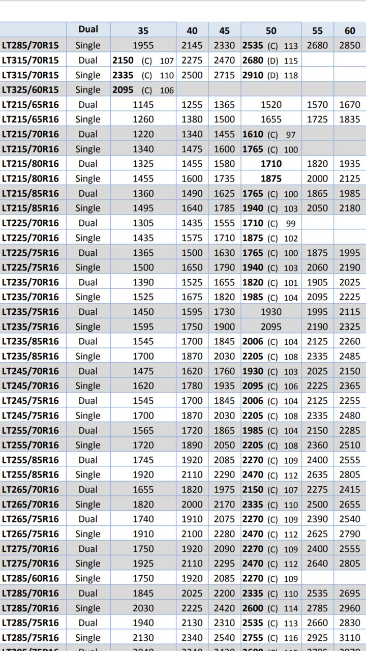

    I just swapped my OEM's for 285/75/16 Toyo AT3's and kept them on the OEM rims. My question is, how do I determine the proper tire pressure for commute/highway driving (NOT off-road)? I'm assuming the "max" on the tire is a bit high and the door sticker/owner's manual will no longer apply.
    If TP is off, they won't wear properly and performance will suffer. And, they weren't cheap! Thanks for the help!

    #336662
    975
