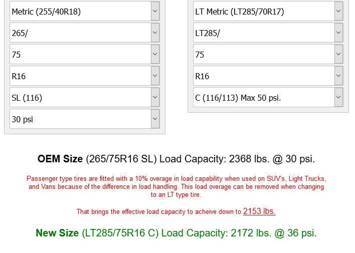

    I like the idea of the chart that "splitbolt" provided over the bias ply chalk test (what, too easy?) but, I have to admit, I don't quite get it. I'm neither a car guy nor much of a math guy :)homer:doh!) and would need some more information.
    Such as, is the 2,149 representative of an OEM tacoma (I don't have my old tires) and I use the 1,954 value? How do I use that value?
    I get the tire size on the vertical axis of the chart, are those psi across the top?
    What are the intersecting values, weight/tire?
    I'm genuinely interested, can you spoon feed me how to use this?:help:

    Try the calculator I linked. (Post 19) It accomplishes the same result without any work. This and the chart are based on GAWR and tire size/load ratings. SL and LT tires require different pressure for the same load. And, different sizes require different pressure for more obvious reasons.
    You can adjust the pressure to your liking, but these are a good starting point.

    I put numbers in, but are they correct for OEMs? Looks like 36psi? Thoughts?

    3d gen Tacomas have a inflated load weight of 2,149 lbs-2,172 lbs from P and euro metric tires.
    Examples:
    265/70/16/112 @ 30 psi = 2,149 lbs(Offroad)
    P265/65/17/110 @ 29 psi = 2,149 lbs(Sport)
    P245/75/16/109 @ 32 psi = 2,172 lbs(SR)
    The vehicle manufacturer de-rates euro-metric and P-metric tires for use on trucks and SUVs.
    If you switch to LT tires, the new inflated load weight is 2,149/1.1=1,954 lbs.
    Use the LT load charts to find the PSI that attains this weight for your particular size.
    What I did was extrapolate a value for 1 psi based on the weights between 35 and 40 psi to arrive at the 31 psi recommendation. I will concede, LT tires are supposed to have a minimum inflation of 35 psi, but I feel comfortable calculating it down to 30.
    This Toyo pdf explains it more in depth and has all the charts.

    OEM should be 265/70/16/112

    @splitbolt definitely understands this stuff better than me. That's why I use the calculator. :D
    But, you must start with the OEM tire size and pressure specified in your door jamb. I don't believe 265/75/16 was a stock tire size. I could be wrong, though. :notsure:

    Okay, it came out to 35 instead of 36. So, there i have it...
    Set a base "cold" psi around 35 and it will vary anyway and, more importantly, generally be fine. They are set so high now they are obviously crowned.
