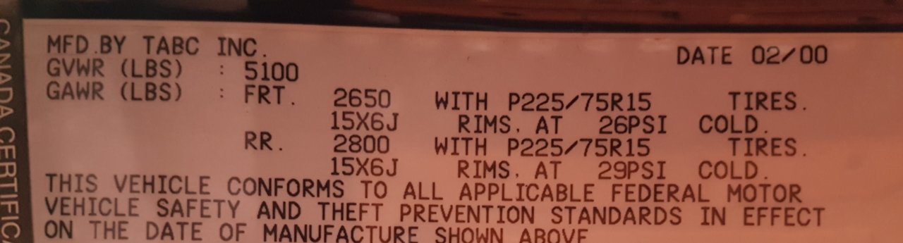

    I notice you have a 2000?
    Things changed mid-2000s regarding door placard psi...
    I'm just curious about the info, since it pre-dates the changes and I'm not that familiar with 1st gens. Could you post a pic?

    Yep...definitely pre-TREAD.
    Pre-TREAD was based more on 'normal' loading conditions and had a lower dynamic load factor of 1.33, based off GVWR; compared to 2nd and 3rd gen, which have a dynamic load factor of 1.54.
    You are wise to inflate for significant weight increases.

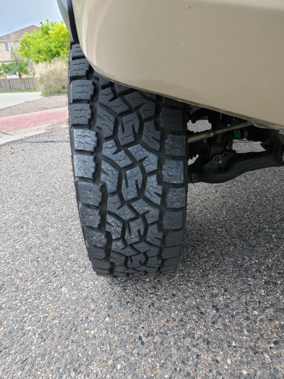

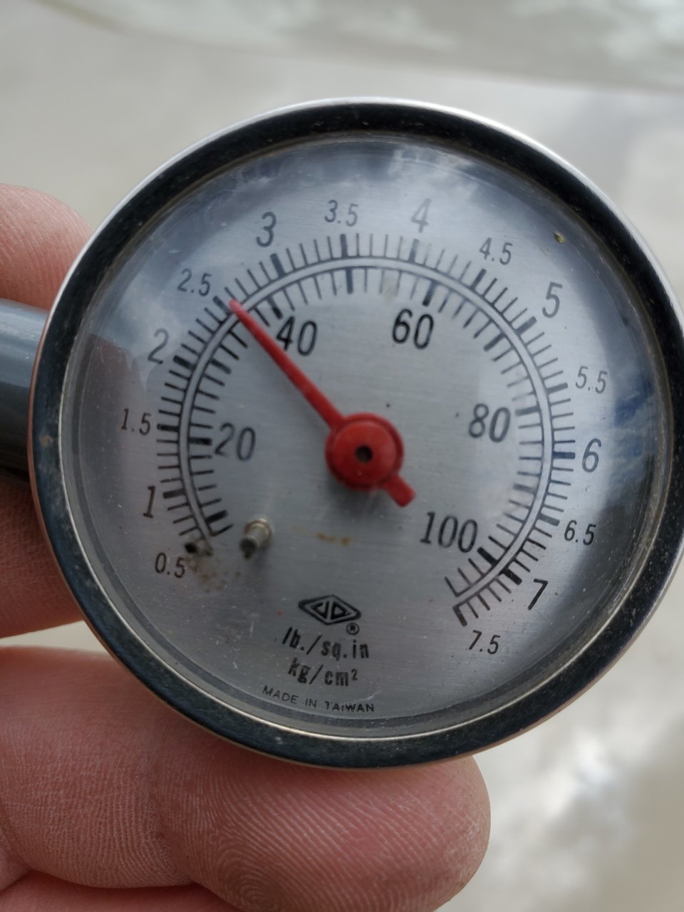

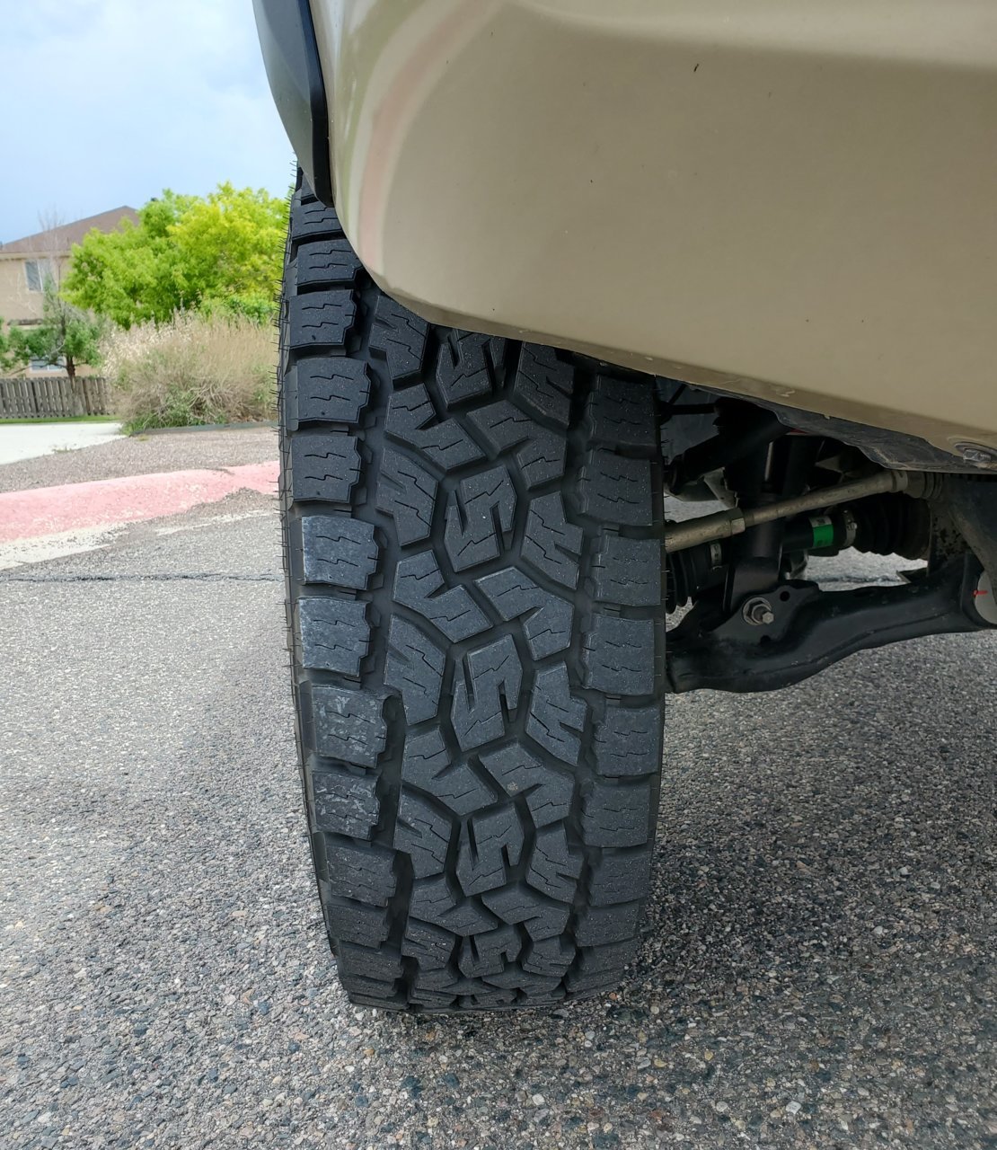

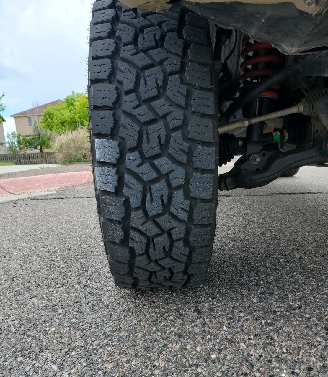

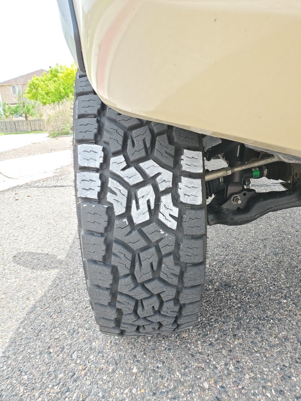

    Okay, it's been a few days; work, rainy weather, home, wife, etc. You get it.
    So, I finally got around to doing the chalk test. But, I'm keeping in mind the link to the online calculator that generated a 35psi based on previous tire for the vehicle. I can't begin to argue bias vs radial tires for test validity. However, for me I'm looking for a good contact patch that indicates the right sort of wear and grip for the tire, roughly speaking. To be sure, we are roughly speaking aren't we? Pressures will vary anyway due to a number of factors so, I'm reasonably certain that I'm in a good range for mileage, safety, and wear. Again, wear was my biggest concern...they're expensive!
    I started with a good chalk patch. For those that saw this from the beginning, I was able to man-up enough to beat up the neighbor kid and take her chalk. I'm swelling with pride!
    Pressure (cold) was at 44psi. To be fair, I told the Toytec fellas to "max" tire pressure until I figured it out. Below is the first bit of wear at 44psi:
    tried it again at 40psi. Close but a little more...
    Here we are at 36psi. Bias or radial arguments aside, for me it is interesting that the calculated pressure and the chalk test appear to coincide. I could likely go up or down a pound or two with little consequence. This is exactly what I wanted. Thanks all for the input.
