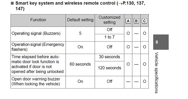

    How do you disable the keyless entry beeping on the 2024 Tacomas?

    Head unit?

    Starting P. 635 (Please read yer manual):
    Some function settings are changed simultaneously with other functions
    being customized. Contact your Toyota dealer for further
    details.
    A:Settings that can be changed using the multimedia system
    B:Settings that can be changed using the multi-information display
    C:Settings that can be changed by your Toyota dealer
    Definition of symbols: O = Available, — = Not available
