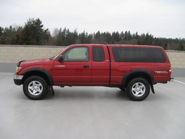

    This is just a dealer photo, haven't taken any good pics yet due to the weather.
    The only difference now is that i took the mud flaps off and put some 2000 4Runner sport wheels with some 265/75/16 Goodyear MT/R's.
    Trying to decide if I want to keep the 265's and do a real mild lift or if I should get some CO's and do 285's.
