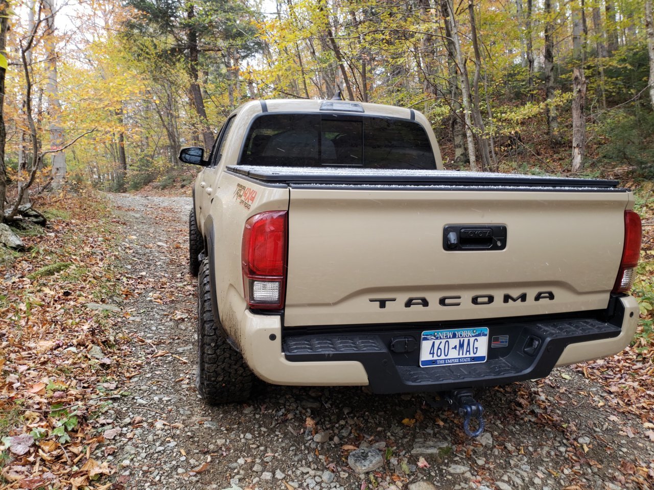

    I have 285's with a -18 offset. They stick out this much

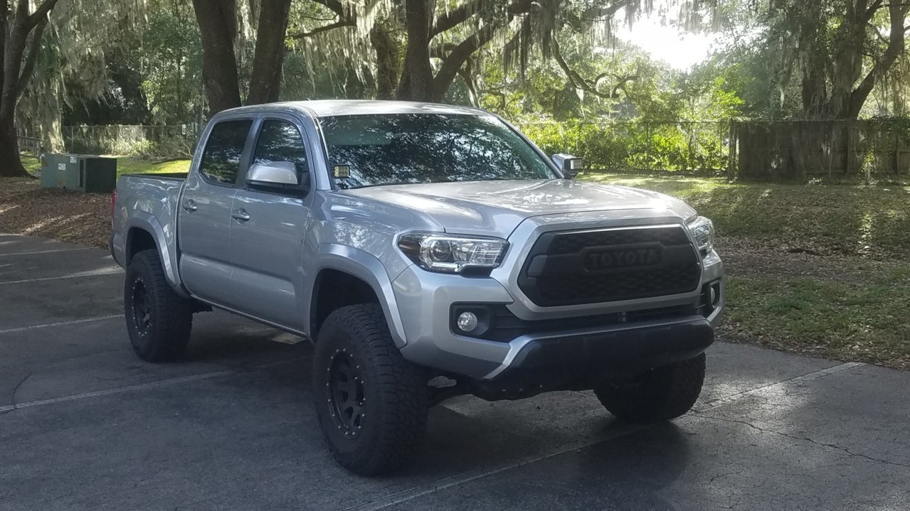

    here's a little more visual reality
    17x8 BS.4.5 offset 0
    for me, this is a perfect balance of form & function.

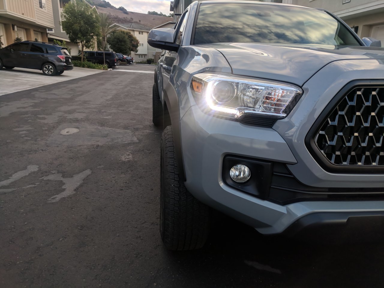

    This is -12 offset with stock Goodyear Wrangler OR tire. These wheels are also 8" wide, vs the 7" stock. Both offset and width can dramatically change the amount the tire sticks out.

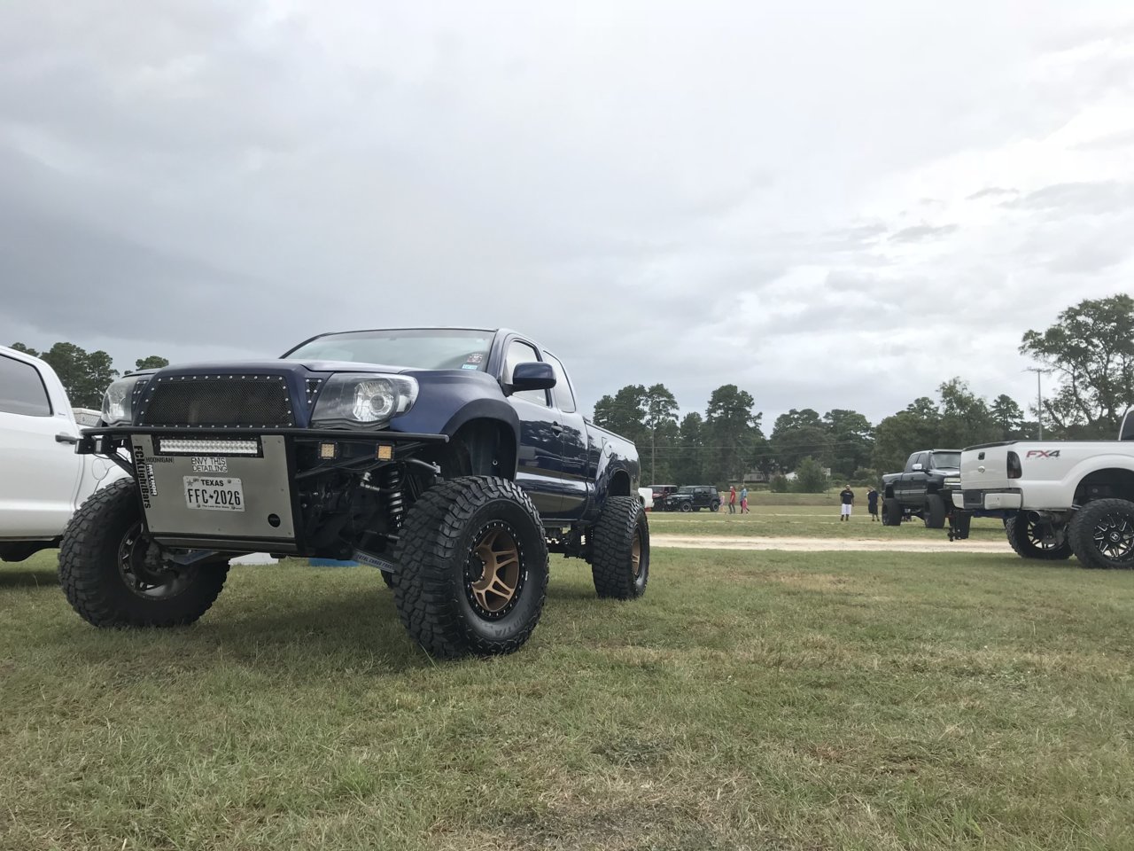

    The easiest way to get a lot of wheel out of the fender is long travel suspension. Mine is +3.5 on each side, Maxtrac spindles adding .75 on each side, Method 17x9 wheels with -44 offset and 12.50 wide tires. My rear end has 2" wheel spacers which is the next easiest way for extra width. When looking at wheels, less backspacing (mine are 3.5) and more negative offset will make it stick out farther. For reference my truck is 90" wide. One picture with fiberglass fenders and one without

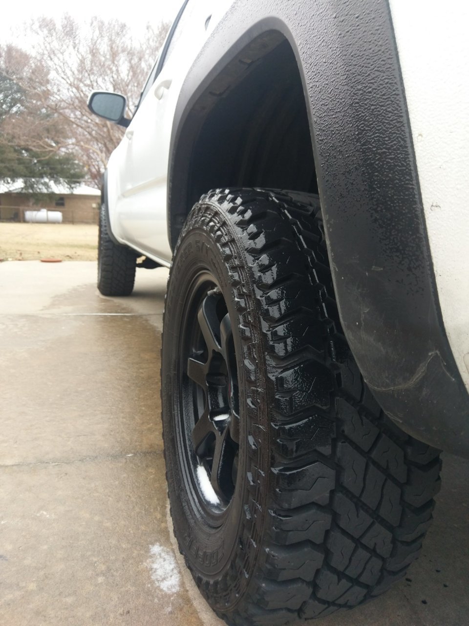

    This is -12 with 265/70/16 wildpeaks. It’s about flush with the top of the flare
