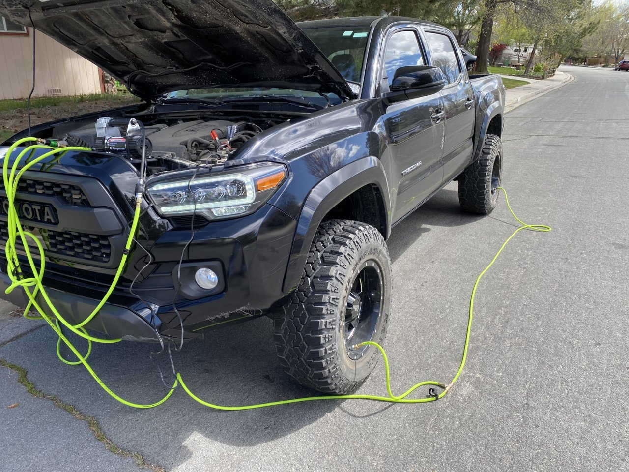

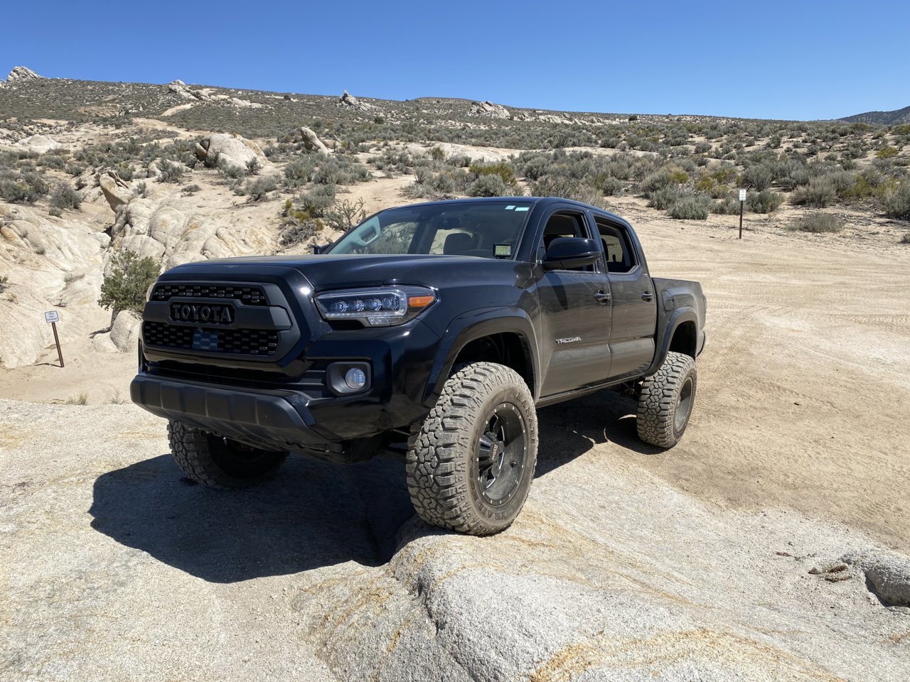

    EF259454-73F5-4637-890B-965BB27FE5A2.jpg 876223E1-FDB7-4FEF-A0AB-D17FDF4348EB.jpg I’m running 17”x10” with a -24 off set. No spacers. Wheels stick out past the fenders about 2”. Makes my truck feel planted and more stable then my old wheels. Tires are 285/70/17. 3” fox/icon lift.
