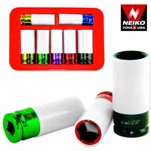

    Snap on makes them so does Mac tools and Matco……

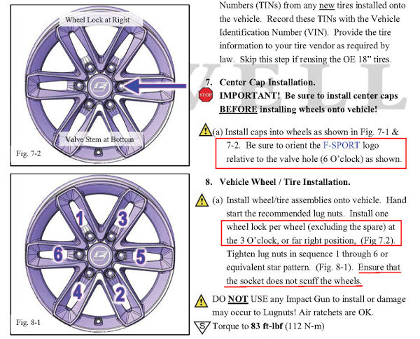

    It's written into the work instructions. Both the center cap and the wheel lock have specific clocking relative to the valve stem, for example:
    Pages%2Bfrom%2BLexus%2BFSport%2BWheel%2B_e356dba7fe72eb69b5428ce7eeb49b421dfe0f30.jpg
