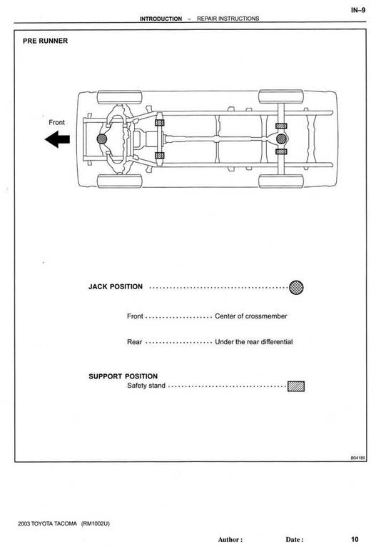

    I use Big Red jack stands from Tractor Supply with some plywood under them, they get to the height without problems. They are positioned on the frame rails, just past the bend behind the front tires.
    I use a large floor jack with a 8x8 block of wood, it is actually in the foreground. I position the jack and wood block in the center of the front crossmember. Remember to chock the back wheels. Double check the jack stand contact points to be sure they are seated properly. Give a good shake to make sure its all stable.
    Sometimes I leave the floor jack in place, but back off the tension to let the jack stands carry the load. The floor jack is there just for safety.
    In this photo, the truck was up over night, so I took the floor jack to the shed.
    **I just noticed you have Pre Runner, the jack stand locations are inside the frame rails, see last picture.
