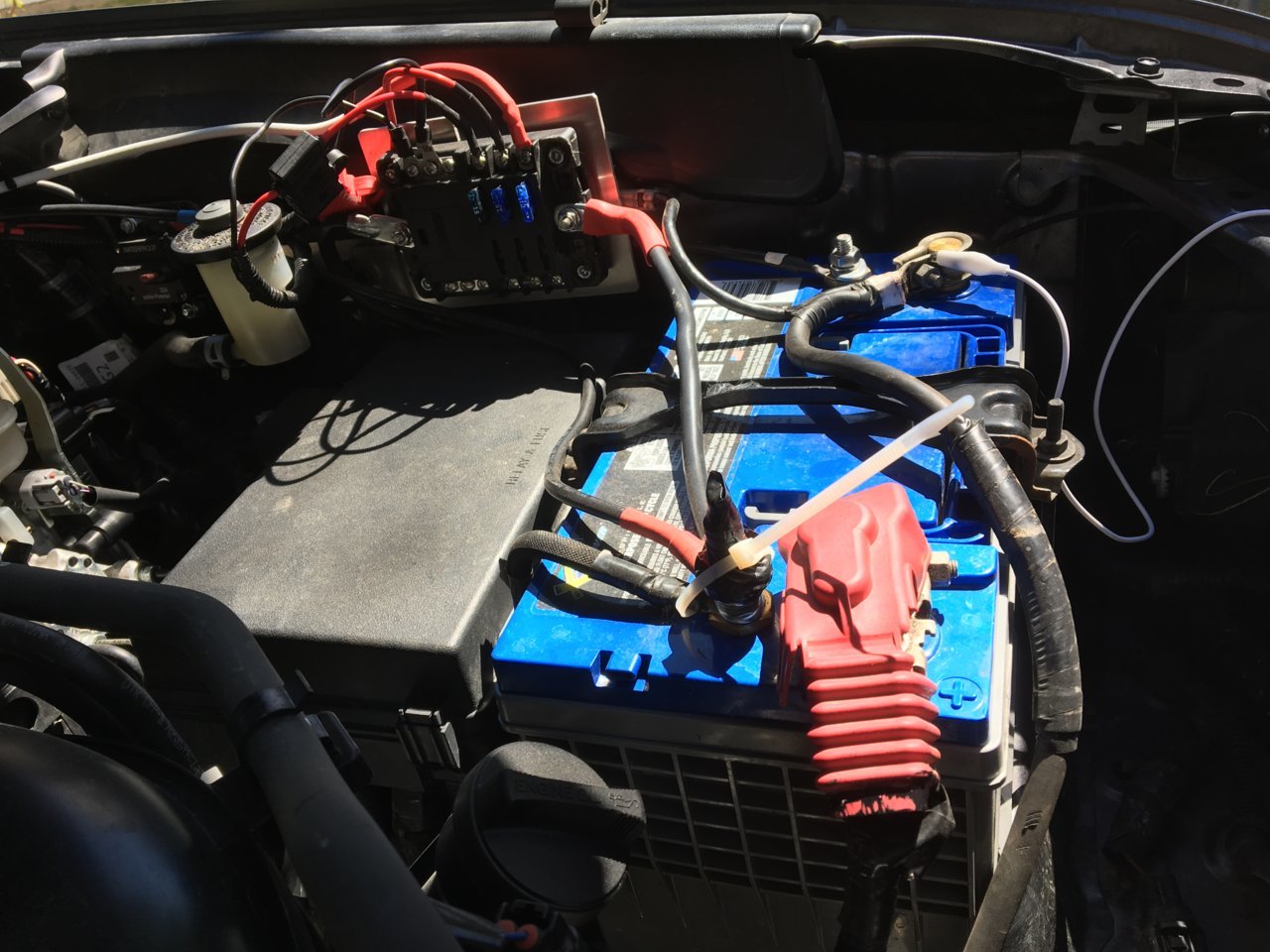

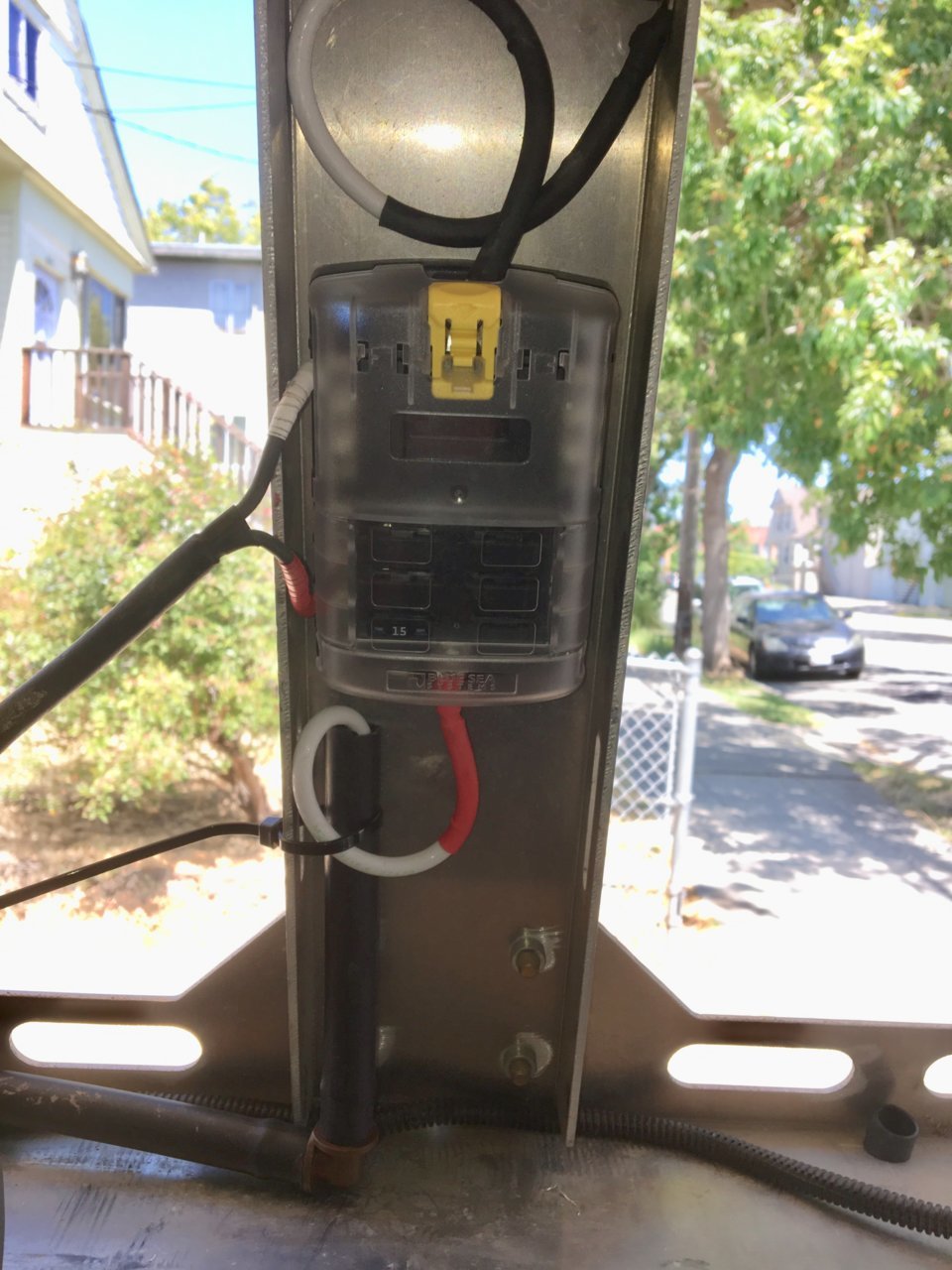

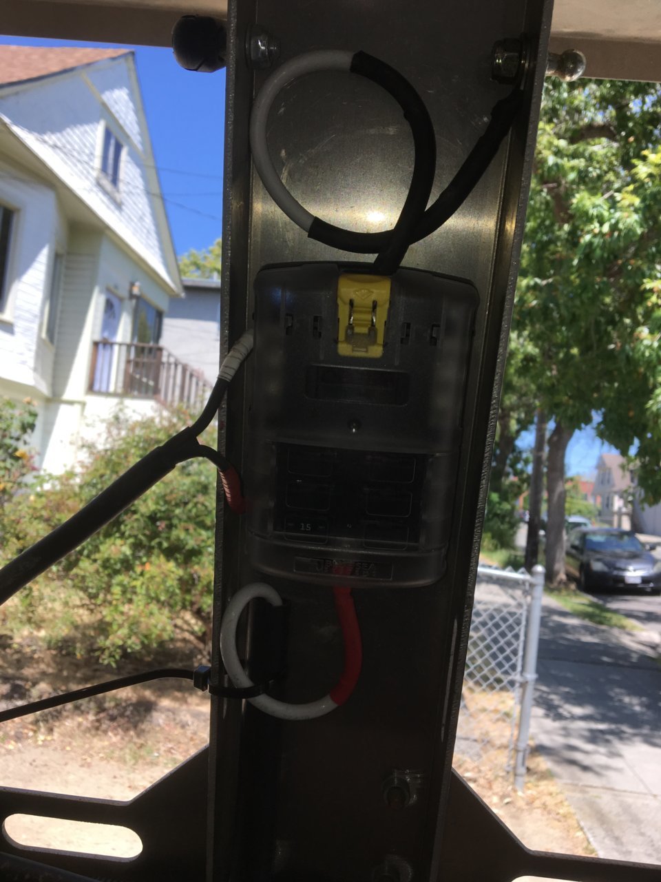

    To clear things up a bit, I have a 6 circuit blue sea box w neg bus in the engine compartment. I realize the wiring is sloppy here and I’m going to tidy it up once I figure out what my next step will be.
    Then, I temporarily have the 6awg wire coming from a circuit on this panel going to the same type of fuse box mounted on the rack (bed location).
    So after tightening things down again, and removing the fuse from the fridge circuit at the panel mounted to the rack, I’m getting .00 drop at all points, from battery to fuse slot at panel installed on the rack.
    When I replace the fuse, and with the thermostat on the lowest setting, there is .15 drop at the battery, and .24 drop after the first fuse (panel under hood).
    Then hooking up the extension cord to the neg batt post with a clip lead, there is .17 drop between batt pos and neg at the other end of extension cord.
    .35 drop between pos terminal (where the pos comes into the panel) on rack fuse box, and .42 drop after the fuse on that same panel.
    Without load, there is .00 drop when measured between pos on rack mounted fuse box and the frame. With load, there .24 drop.

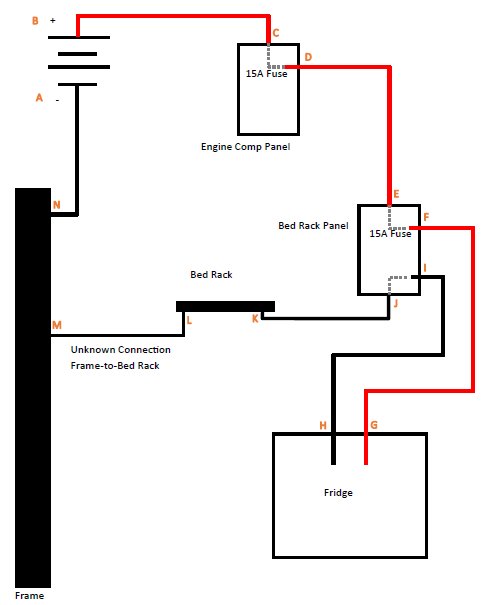

    Had to make a sketch, this look right?
    Next step (for me to be able to help any) will be to figure out the voltages you are reporting (or voltage drops) via letter, Vg-h, Ve-a, Vc-d etc....
    That said, each of those 15amp fuses is using about 0.05 - 0.1 volt each, depending on the exact amperage... so they are definitely adding up.

    This looks right with the exception of the engine compartment fuse panel which is connected directly to batt negative.
